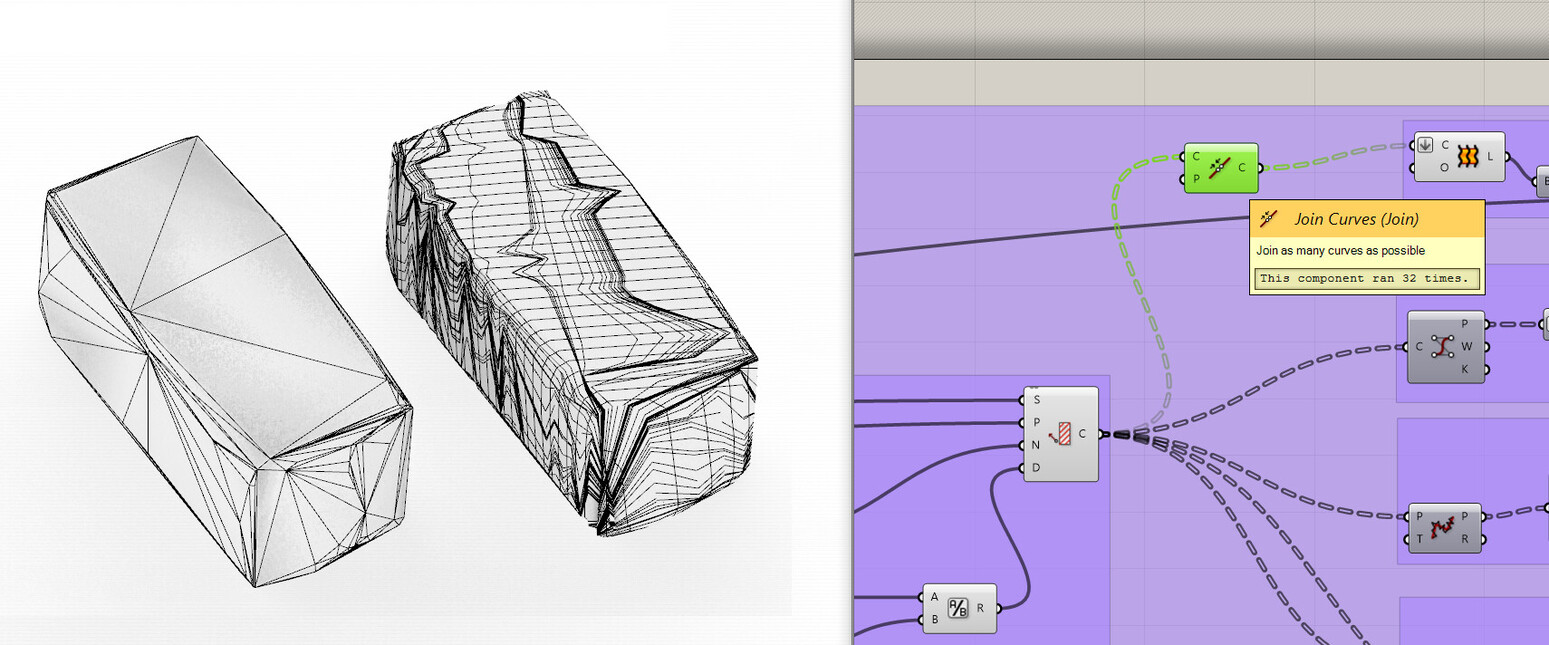

Hi everyone,
I am a beginner in GH. I was trying to import a closed mesh and calculate the geometry of the mesh. I am trying to create a sketch loft and calculate the volume of the mesh model which created from the sketch loft. However, an error existed which stated that the curve generate from the loft is not closed or the volume cannot be computed from an open brep. Here is the gh. mesh anlayze.gh (30.2 KB)
Also, the imported mesh model file. convex hull.obj (10.7 KB)
You need to join the contour curves before the loft as some of them will be in pieces:
It’s a pretty messy loft doing it the way you’re doing it, but anyway this is the result.

If you look closely, the first curve made by the contour component is non-planar, which means the resulting brep will not cap (it needs planar curves). You’ll get a more reliable result by using a mesh-plane intersection when generating your curves, attached is an example.
mesh anlayze (edit).gh (12.7 KB)
Whichever way you do it, the resulting brep is a little bumpy, so you may wish to rebuild the curves and alter the seam position before lofting (I’m not going to do that though). Best of luck with it.
