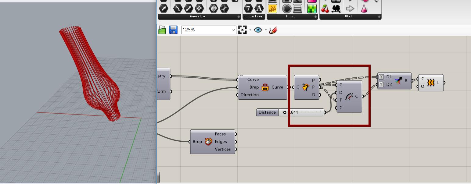

Hello all!
I would like to extrude these curves off the surface to create fins but i’m currently facing difficulties.
Appreciate if you could advise on how to proceed.
Thank you!unnamed.gh (10.1 KB)
Untitled3.3dm (39.7 KB)

HI Yu_Heng
1:First you can create a work plane
2:Then the offset curve on the plane
offsetCurve.gh (9.0 KB)
