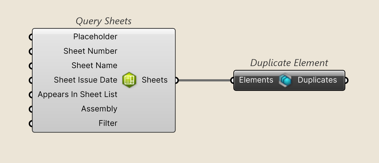

I was wondering if we could have a component in RiR for duplicating sheets and views?
I know I can manually create a new sheet, copy all the parameters, search for dependent elements, get their locations, clone views, etc., and maybe I’ll finally be able to create a robust script. But I was wondering if Revit offers any methods for this specific task, or if developers would have to write a longer script similar to what I’ve described.
If not, well, I’ll have to create something as universal as possible myself.
PS. I didn’t find a way to batch duplicate multiple sheets using pyRevit. I think I can do it using Nonica plugin and probably others but anyways… I’m asking for the simplified Grasshopper solution because I can connect it to other logic.
If you know how to code, you can use the following method and create your own component.
or you can try this light solution
Unfortunately I don’t know how to code, I’m pretty fluent in Grasshopper.
It would be good if this light solution would work for the Sheets and all elements placed on them. I don’t want to duplicate empty Sheet. My previous screenshots shows a few options in copying Sheets.
When Sheet contains Viewports I don’t think it’s possible to copy it like that.
as of now there is no such component, it has to be developed.
