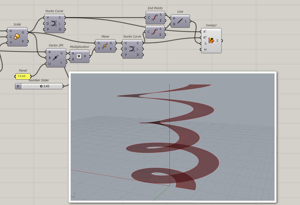

How can I use gh to create this kind of helix?
Did you take this object apart in your head? Would you know how to model it in Rhino?
Hello
I see an helix curve with radius changing along the axis. As the change is quite continuous I’ll take a
Radius(t) = RadiusMin + (1+sin(A t))(RadiusMax - RadiusMin)/2
Helix Spiral from Nautilus plugin or elsewhere
But if you want a constant slope, I think you’ll have to make your own tool.
