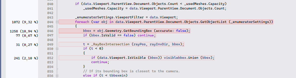

kitjmv
(jmv)
January 2, 2023, 3:57pm
6
On the other hand getting the bounding box is slow, I recommend storing the bounding box of your objects in a list (for example) rather than using Geometry.GetBoundingBox(accurate: false)
in your loop
here are the execution percentages for a loop of 260000 objects:

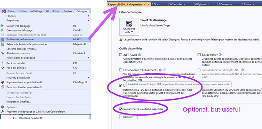

mrhe
(Mariusz Hermansdorfer)
January 2, 2023, 5:21pm
7
@kitjmv , what kind of profiling magic is that? Is it Visual Studio? How can you benchmark your code with corresponding percentages of execution time per method call?
kitjmv
(jmv)
January 2, 2023, 5:36pm
8
Mariusz Hermansdorfer:
Visual Studio?
Yes !
I don’t know, but I haven’t read the documentation.
My approach is stupid, if it’s red, it’s not good. If it’s not red, it’s fine
