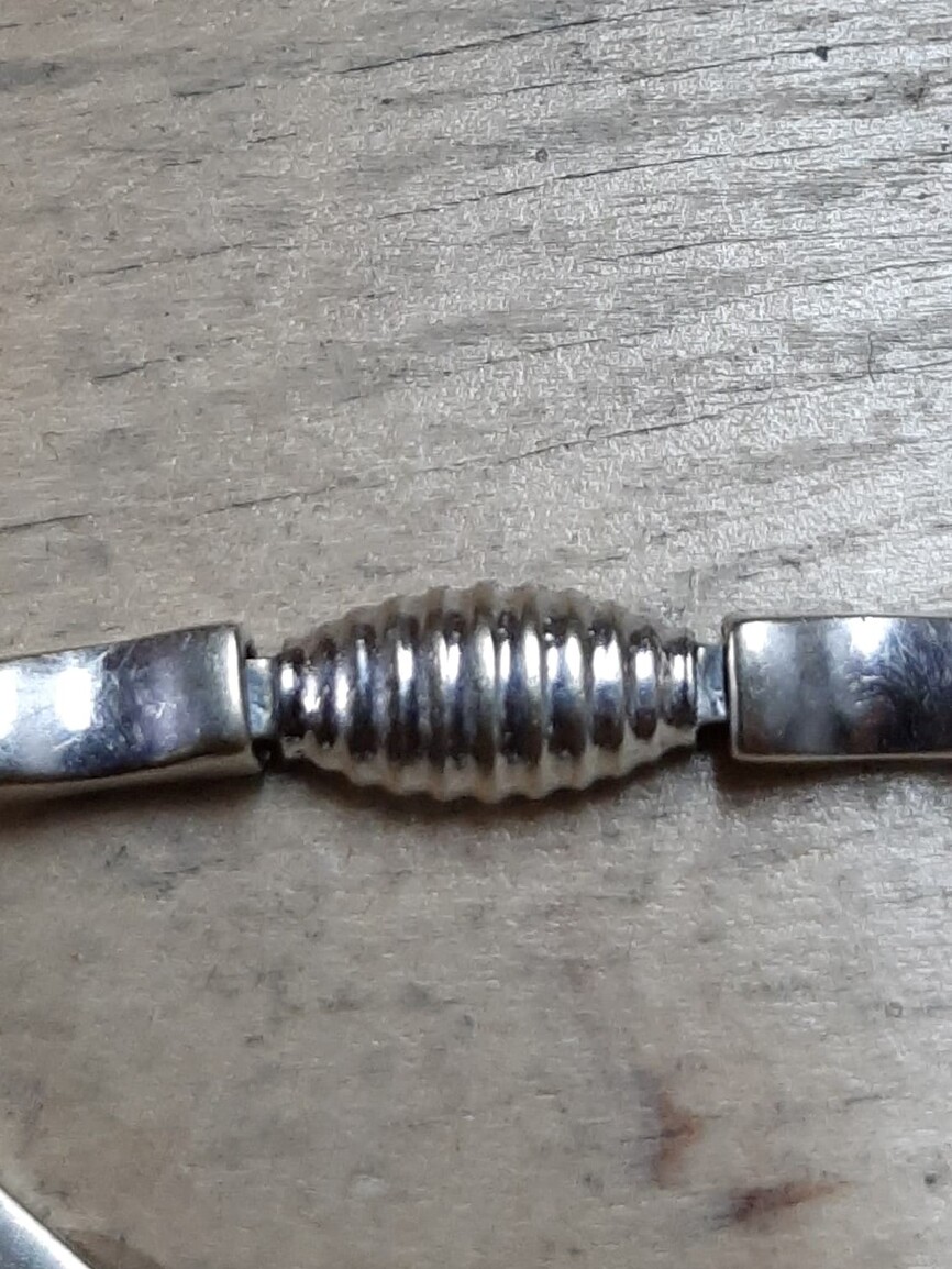

How can i make this object look like as shown on the picture
part 2.3dm (112.0 KB)
1.-revolve with the appropiate curve shape
2. revolve oval curve ,contour , make pipes, boolean (easiest)
