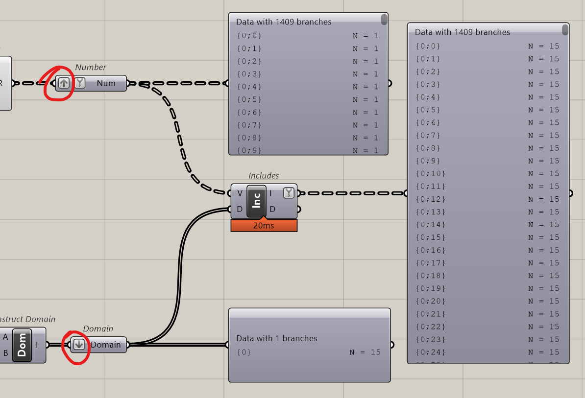

I met a problem about two trees interacting.
As you see, tree ‘layers’ has three branches, they are numbers; tree ‘domains’ has 15 branches, they are domains. Now I need use the domains to evaluate each branch of ‘layers’, thus I should I have a new tree of 45 branches.
However, I got the new tree of 15 branches.
Could anyone help me fix the problem?
Thanks a lot!!

for instance, if you want to compare each item of layers to all the values in domains you could graft the Layers and flatten the Domains:
it will produce a tree like {a, b} (c) where:
a = original layer branch of each Layer (in this case 3 branches {0, 1, 2} )
b= index of item in branch (for a=0 → 457 branches, a=1 ->462 branches, a=2 ->490 branches)
c= 15 values, one for each Domain that gets checked

What I want is to use domain check each layer. So finally I should I have 45 branches.

the example in my previous post could be worded like: compare each item in each branch of Layers with all the items in Domain

However, it’s still not what I want. Because I need 45 branches. @aquintana 's solution is very clost to my aim.
Thanks again!
Thanks a lot, @aquintana!!
Yes, you got the results I want.
Do you think can we move further: if the branch numbers of ‘layers’ are not fixed (here is 3, it can be 200), I have to create losts of ‘incluse’ to hold the big number of braches.
Thank you again!
