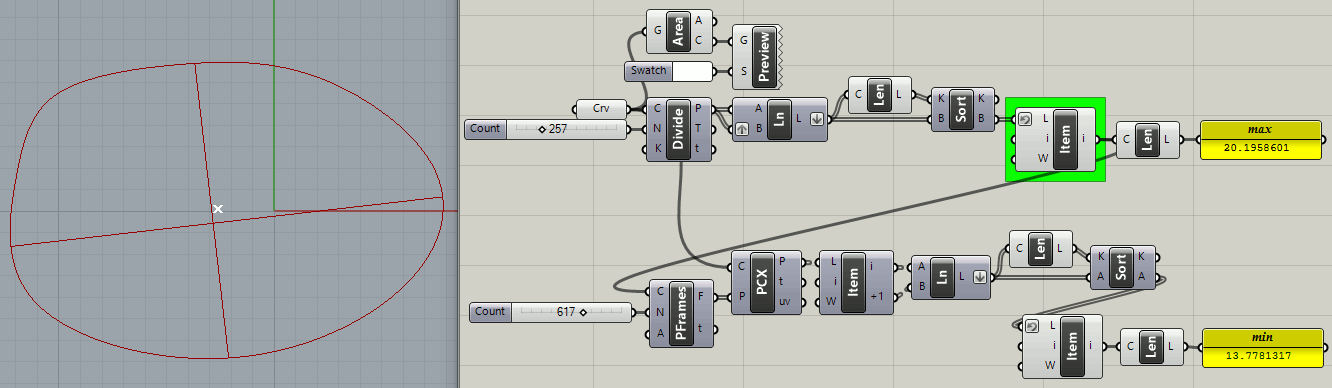

I have a like-circle shape (a closed 2D curve), and I want to find two “diameters” of it. One is the max diameter, which means the max distance between two points on the curve; the other one (min diameter) is the distance perpendicular to the max dimameter, and should be max in this direction. The attached pic shows my demands.
My idea for the max diameter is that, I segament the curve into many points, then measure the distance between any two points then get the max one. However, I don’t know how I can ge the min diameter.

I think I have some unclear meaning of the “min” diametere. What I want is the diameter perpendicular to the max one, while it is not necessarily the minimum diameter.
Hi Joseph, thank you so much for your kind help. I need to try your code to understand it. The “min” diameter I mean should be perpendicular to max one, but maybe not the really minimum one.

Hi James, I just tried you code. You choose the middle of the max diameter as the location of the min diameter. But I don’t think it will ensure the min diameter has the max length in this direction.

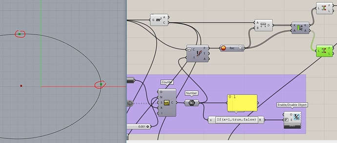

Here is a third method, not restricted to passing through the Area ‘C’ (Centroid, white ‘X’), that finds a slightly longer distance between two points on the curve. The min “diameter” is then derived by rotating the max line around its center point and is very slightly longer than the min from the previous method.
Now I wonder if there might be a shorter parallel line to this min? Actually, there are many, down to zero length, so let’s ask a different question: Where is the longest line perpendicular to the max length? Aha, I see you just asked the same thing. Here:
Hi Joseph, your “d” code is perfect!! And compared to all the codes, this one is the most accurate and fast.

The explanation is that you were not clear in what you were asking for originally, so I did my best to guess at what you were after. The definition I provided to you would be really easy for you to edit to behave the way you want.
Hi Seghier, I downloaded three plug-in before I could use your code . However, it’s still difficult for me to understand it. Could you pleae offer some instruciton?
