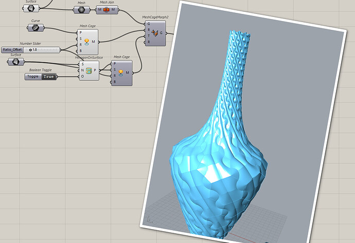

I tried some plugins to put hexagons on a surface with a seam.
I tried lunchbox, ngon. I didn’t try Paneling tool. These tools have problems or the seams (lunchbox, or too much points (polyline with 9 points for ngon plugin), not hexagons at the ends, or too much distorsion …
As I need quite nice hexagons I developed a little tool 2 hours work).
You just have to put the number of hexagons on a ring and say where is the seam (U or V).

and here my tool
And now on 0.5 version a tool to make hexagons on a surface with seams, like a revolved one a tube, a pipe, … You just have to give a surface, a number of ring and to specify the orientation
It will gives quite regular hexagons/polylines with 7 points.

Secondly to morph I use @DanielPiker tool MeshCageMorph2
Here’s a version that should work with any geometry - Breps, trimmed surfaces etc.
MeshCageMorpher.gha (11.5 KB)
morphdemo.gh (138.8 KB)
Because Space Morphs of NURBS objects don’t always end up with the same number of control points as they started with, it’s not possible to precompute the weights like it is with the point version, so it will be slower. If morphing Breps, you might find it helps to mesh them and use the mesh for previewing changes while setting up the morph, and only replace…
So first draw an hexagon above your tile, that is not centered and doesn’t seem to hexagonal from above. Then plug my component MeshCage
It will make a mesh cage that will be used by mesh cage morph
Plug another mesh cage to the hexagons on your surface.
At the moment my cage is not too divided because it was enough.
And at the end doing this 3 times, random choosing a tile among 3 tiles. Doing Truchet
