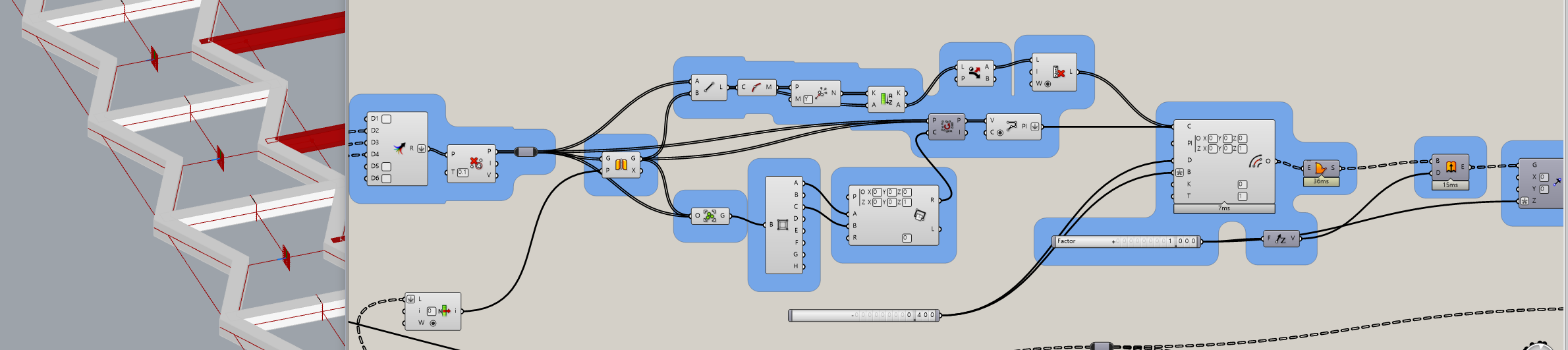

Hi everyone,
I’m building a repeating “hourglass” module in Grasshopper. Each module looks fine on its own, but when I stack them along the Y-axis, I get overlaps at the joints: the top bar of one module and the bottom bar of the next one and create messy geometry.
I’d like the modules to align perfectly edge-to-edge without any overlaps, just one clean line at the joint. Does anyone know any solution to this?
Thank you in advance!
