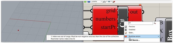

I think that is because startPt’s x,y value have to integer?
I had the same problem, and I solved that with that method
A valid start pt idx is in fact an elementary thing to do. The fastest way:

I opened the file you uploaded, and the same happens to me
Actually I’m going to use the one called from the excel file like the picture above rather than putting in random numbers.
