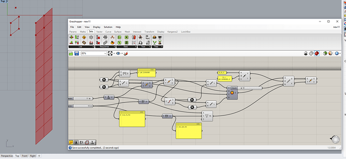

Hey. I’m trying to create a grid with diamond-shaped cells

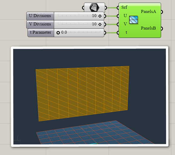

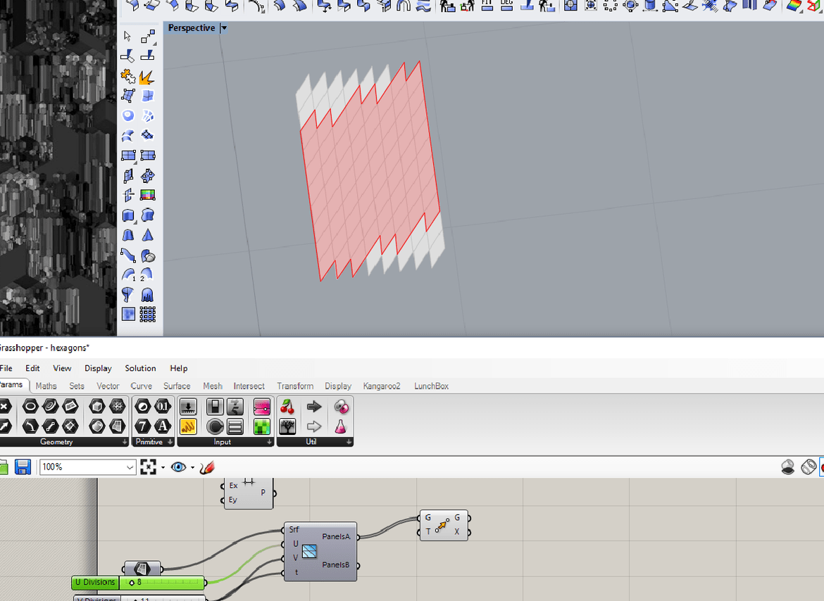

Lunchbox got a component for that.
You could choose ur divisions count by the dimensions of your surfcae / distance you want for the parts.

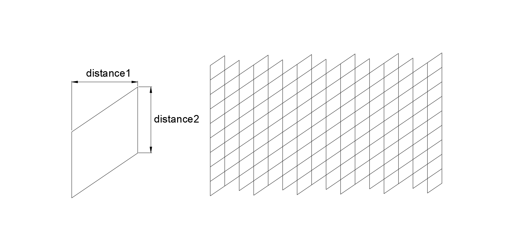

Thank you. And how to get a grid like the Rectangular
component, and how to create arbitrary edge of the grid

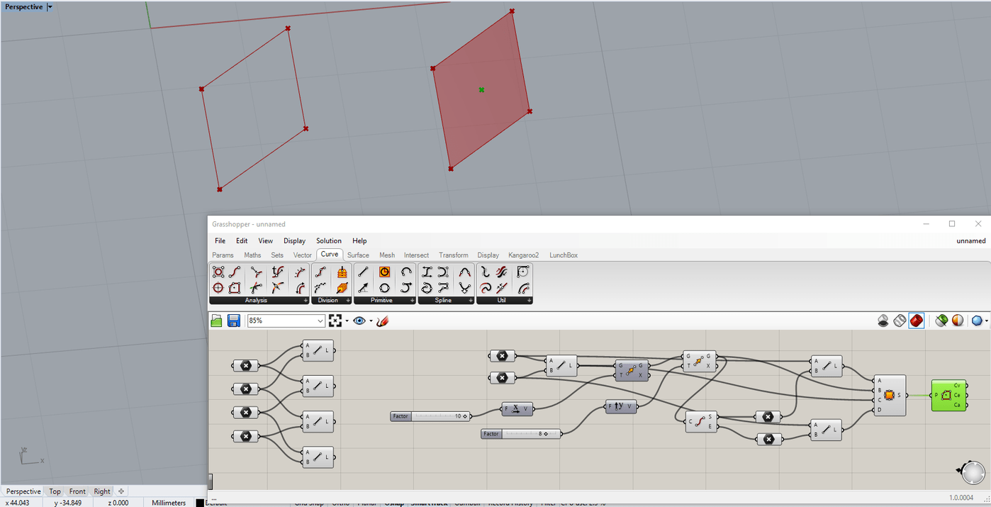

You can write your own equation of the panel. You will need 2 lengths and one angle.

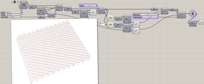

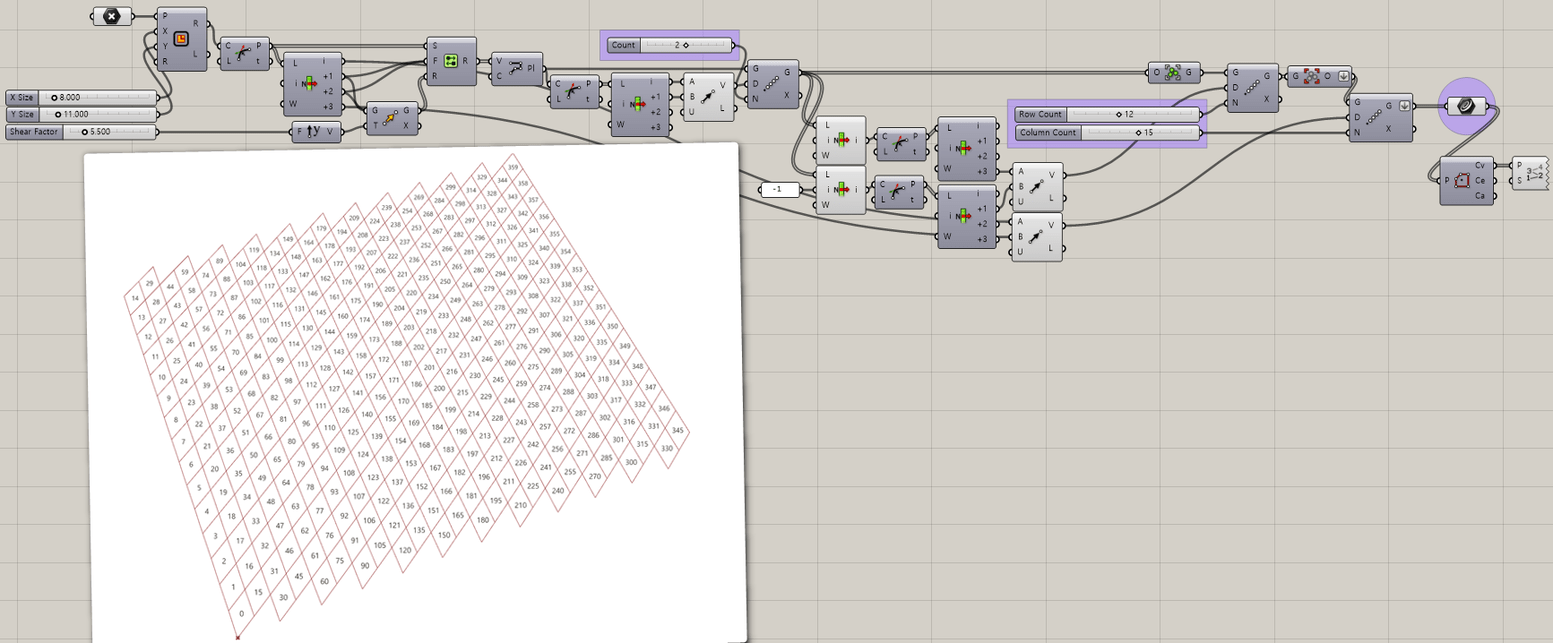

Thank you, how can I use it now unnamed11.gh (11.4 KB)
Thank you!
