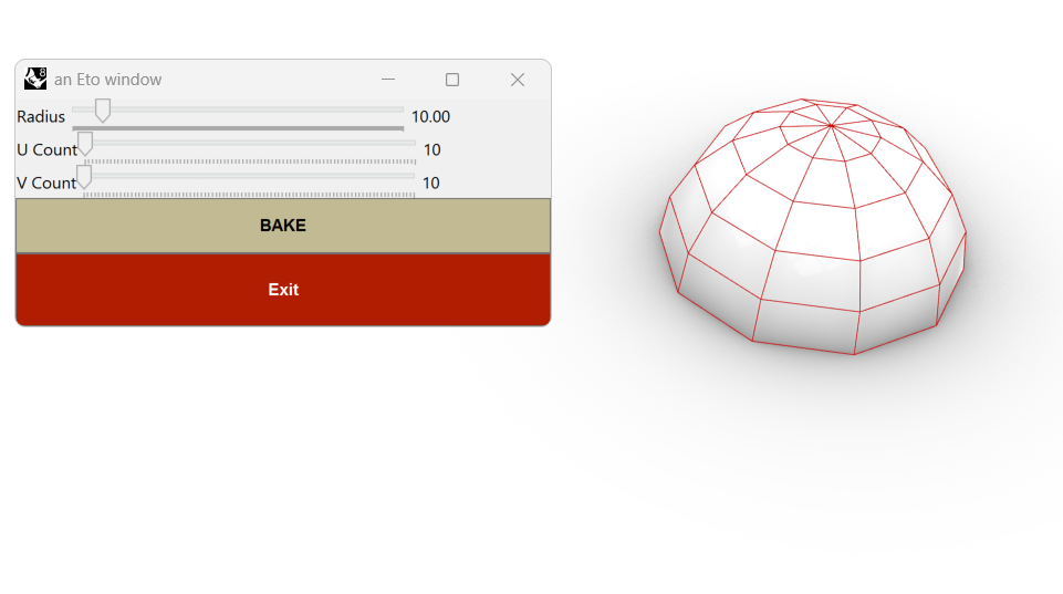

@ale2x72 I’ve just run your latest version locally using GH Player and it is working as expected:
Cheers
DK
@ale2x72 I believe the issue comes up when your script is compiled using the Script Editor.
The script editor compile path MUST HAVE a context input component on the canvas to ‘stay alive’. I cover this in my video here:
Attached is my DKUI version of your script modified to work compile as a plugin with the Script Editor.
You will need to check your closing logic again with this setup as you will lose access to your control with the current version.
Cheers
DK
Test_RCP_DKUI.gh (19.4 KB)
