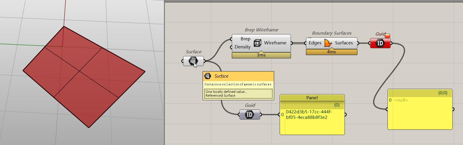

I am still finding my feet with GH. I am trying to get the GUID of a Rhino object in GH. The GUID component shows a null value. It is possible that the null value is due to my lack of understanding of the component interaction.
I found Script Component Guid input which appears have resulted in a fix for the same problem.
I understand that I need the GUID as input to the Python script, which I am hoping will turn off isovcurves for an object in the model.

Because only objects cretaed within Rhino or refercenced from with Rhino can obtain a GUID

I have just discovered that GH can obtain the GUID of an object which was created in GH. That is easy enough ‘after the event’. The next challenge is to find a way in GH to identify the Rhino object which created in GH as soon as it has been created, as part of the GH component chain. Working on it…

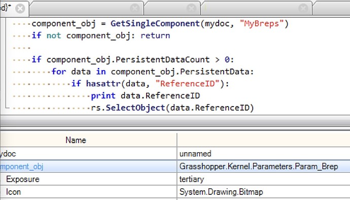

I found the code suggestion below, which hints at a solution to obtaining the GUID within GH.
In order to get this code snippet running, it needs one or more namespaces to be imported. I have searched, but cannot determine which namespace(s) are required. I found the page below which is a comprehensive list, but still cannot find GetSingleComponent. PersistentDataCount and hasattrdata are probably in the same namespace. Any help would be appreciated.

The debug panel in the code snippet provides a clue.
However, Grasshopper.Kernel.Parameters Namespace does not show Param_Brep.

Hi @coffsoft, this is probably some old python 2 code which might not run anymore in Rhino 8.
GetSingleComponent is likely a custom function which justs iterates all gh doc components and returns the first component matching the name (or nickname). PersistentDataCount seems to be attribute or property of the found component. I don’t know if this name is still valid. The hasattr(data, “ReferenceID”) is a build in python function which does not need to be imported.
Yes, i guess it only works if the ids are Rhino object ids which must be assigned manually to eg. a Brep component.
