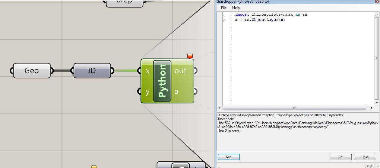

Get layer of an object with rs.ObjectLayer(x) inside Python compnent
I want to get the layer of an object inside grasshopper with Python component using
a = rs.ObjectLayer(x)
Type hint Brep
And I get 1. Solution exception:Parameter must be a string or Guid
What’s the correct way to do this?
Thanks

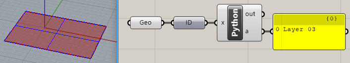

It also works if i do not set any Type hint for x and leave it using “No Type Hint”, but then i have to do the conversion using an ID component:
_
c.
BINGO! How silly.
That also makes the OP’s version work just fine:
python.gh (7.0 KB)
@TomTom, I know you said this too, I just missed it, or didn’t understand it. Thanks.

Doesn’t work for me.
Type hint is no type hint. No type hint works. I can’t choose Guid as type hint.
I don’t understand what am I doing wrong.
(using rhino5)
this solves it; I had just made a screenshot with similar content (before Windows Update decided to take my next 2 hours)…
layers.gh (8.8 KB)
There is a little more info in the definition. Basically, “Type Hint” does, inside the component, the same as what a ID param + No Hint would do. This is always the case, for any param.

That didn’t work in Rhino 5. All type hint values with only a Geo param failed until a Guid param was inserted between the Geo and Python components.
Please open the file above (layers.gh) in Rhino 5 for a working example. You’ll need, of course, to reset the ID param to an object that exists in the Rhino doc. The Guid type hint did not exist in Rhino 5, it was added in the Rhino 6 WIP. The str type hint can be used, too, but it needs a Guid (not geometry).
