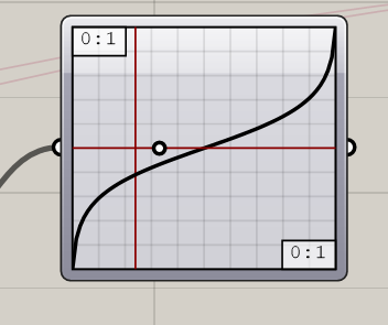

Hi @antoinemaes,
I wonder how you create the Sigmoid graph mapper, whenever I try I get this
But I am not capable of inverting the curve so it is higher at the beginning and lower at the end.
