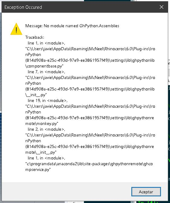

Hi Pierre,
Having some problems with the method, I hope you can help me.
Firstly, if I am going to call a grasshopper user object. that contains all the information about my model… what 3dm file I need to reference? Can it be an empty one?
Secondly, I am getting some some error when running a Pyhton script and calling PythonToGrasshopperRemote… A rhino instance opens but I get some errors:
Thanks.
You can set that argument to None to open an empty Rhino.
I don’t understand how you get the second message. This is an internal import to ghpythonlib, not something directly controled by gh python remote. Do you also get that message when you manually run import ghpythonlib in RhinoPython?
There is a good chance that the first error is actually showing what is happening, but it’s ahrd to tell exactly. Again, I assume you do not get this error when manually loading GH? Is there a way to copy-paste the error code somehow, so I could read what it is saying? Or maybe just a screen shot showing more of the text in the first column? Any reference to a specific GH plugin or user object somewhere?
Hi Pierre,
Thanks for your answer. Apparently, there was some kind of problem with my Rhino installation… after re-installing it seems that the errors are gone and the user object methodology seems to work for initial test.
