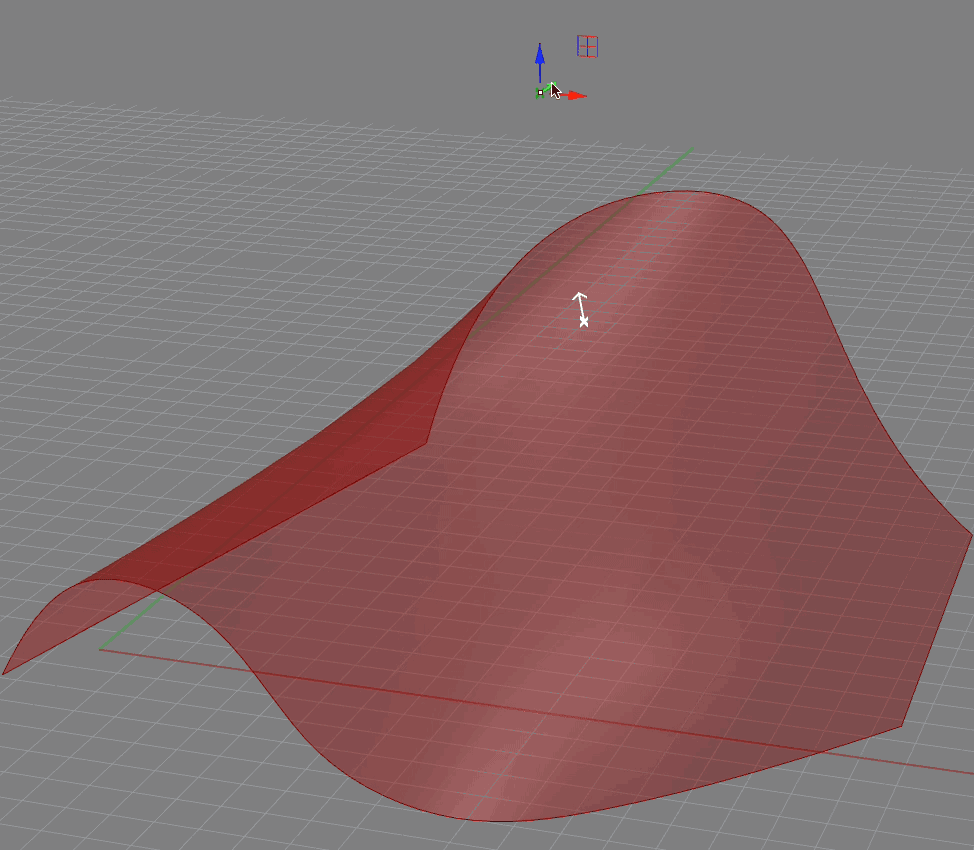

Get uv vector with Rhino python
is there a way to get the uv vector of a surface with python?

Mahdiyar and P1r4t3b0y thank you for the answers. I know how to get surface normals but it is not what I need. I need the u and v as vector. Or maybe I understand here something wrong?
You mean something like this?
plane = rs.SurfaceFrame(srf, uv)
uVector = plane.XAxis
vVector = plane.YAxis
samid.gh (17.3 KB)
Hi Mahdiyar,
your way was also my way :slight_smile: but then I noticed that it’s not the same. When you create a rectangular surface, copy it and change at one of them the normal. The you have two surfaces with same u and v direction but different normal direction. If you now try to evaluate a point on both surfaces then you will get same u and v directions but different planes. That’s the reason why I need the u and v directions and not the plane itself.
import Rhino.Geometry as rg
success, pt, vectors = srf.Evaluate(uv.X, uv.Y, 1)
if(success):
	uVector, vVector = vectors
	uVector.Unitize()
	vVector.Unitize()
samid.gh (23.6 KB)
Thank you, I will try it out on monday and give an answer. Have a nice weekend.
Hi Mahdiyar,
perfect it works. Thank you.
