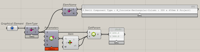

Hi Guy,
In Revit model for example

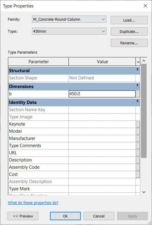

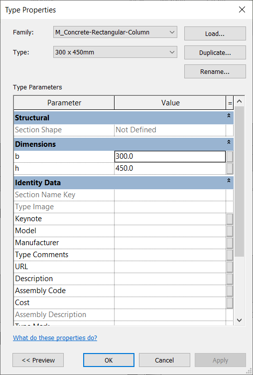

I have two structural columns type are rectangular and round
How I can get the dimension of Type
rectangular are 300 and 450
round is 450
Thanks
like this…
Thank you

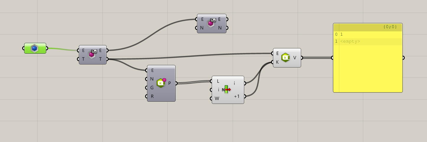

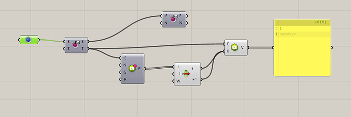

I make component follow you but it not work

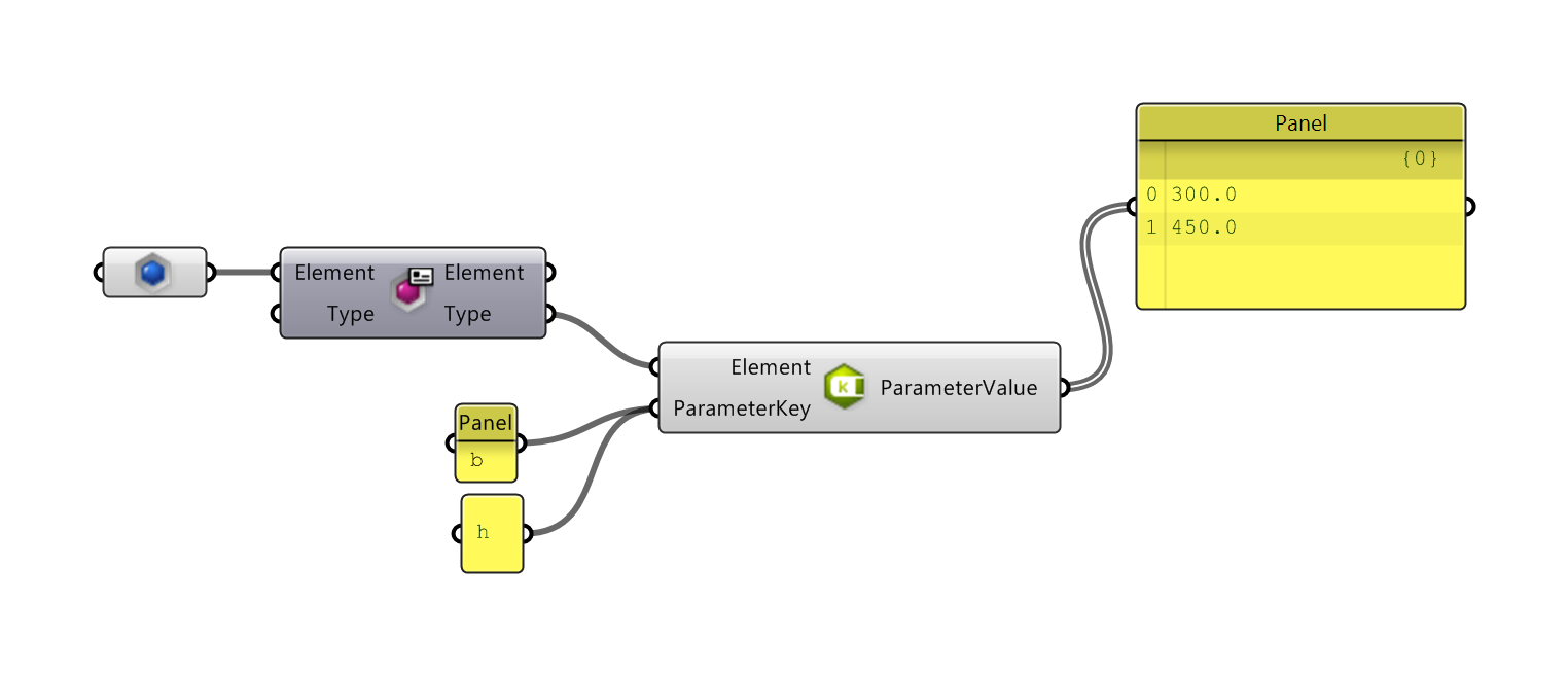

hey @duchoabn,

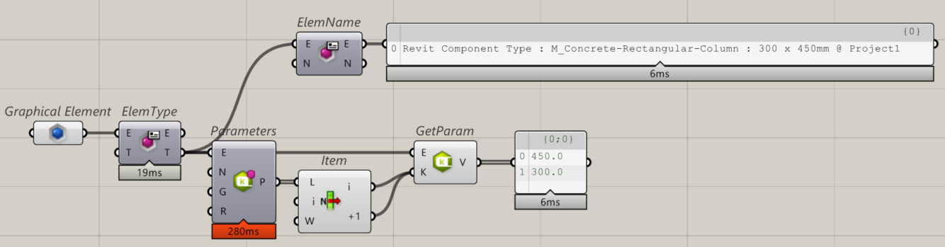

Following will give you the parameters you want as well. This is kinda manual method. You have to select the elements you would like to have parameters of. Type in the parameter name and it works. In this case, parameters are type parameters and parameter names are “b” and “h”.
yes, just make sure that (i) in the item component is indexing the correct parameter from the list
