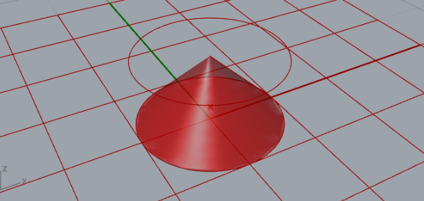

I have this cone

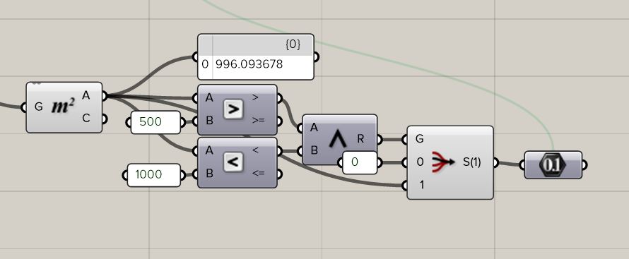

I want its area to be within a certain range and i want to compute it with Galapagos
To accomplish that, i was thinking to use a function, but it doesnt work

Sorry for the late reply. Thanks a lot to both. Is there any known reason why it doesn’t understand the formula that i wrote?
@HS_Kim’s file has the clue. Data inside panels is text, you need to convert that to actual numbers before ‘less than’ operators will work.
