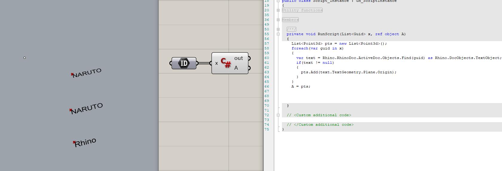

I was just wondering if there’s any chance I could turn these texts into points with some sort of Grasshopper component. I attach a screenshot. Thanks in advance
Hi Fernandovelazquezg
You can use the human plugin or you can use my simple code below.I hope this help you.
TextLocation.gh (1.8 KB)
Hi Naruto,
Thanks a lot for your help. This is precisely what I was looking for :). Cheers!
