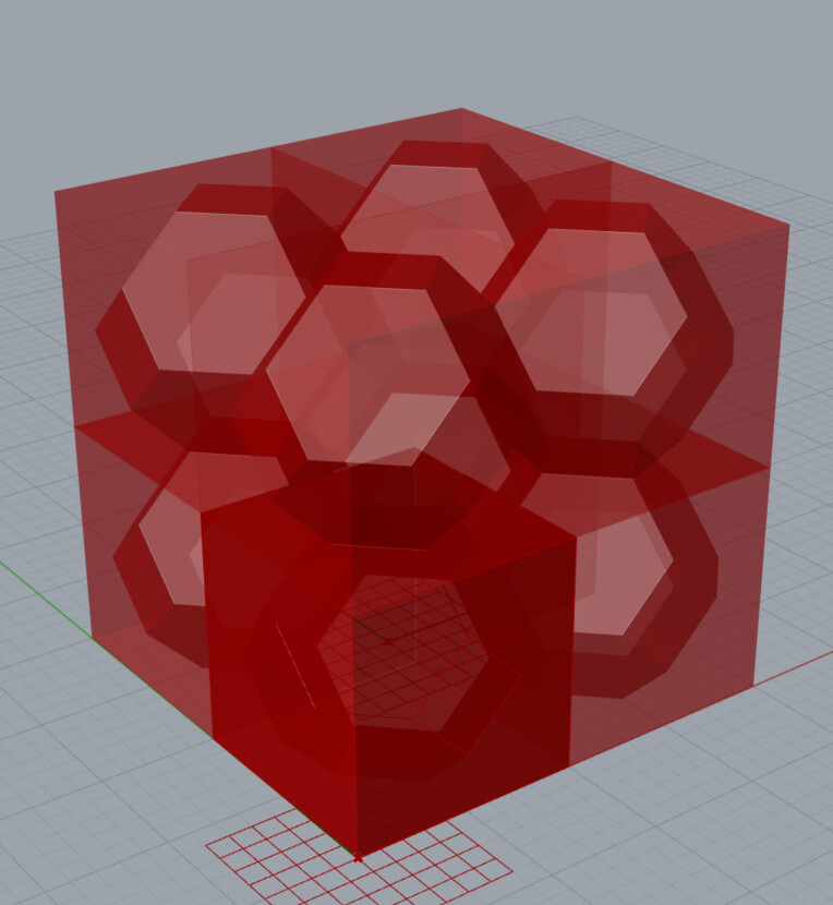

I’m new to Rhino & Grasshopper and need to use them for my thesis on 3D printing.
I’m trying to create an infill pattern using truncated octahedrons, but I’m struggling to fill a cube with them as tightly as possible. Any help would be greatly appreciated!

Yes
you just have to do the math. For cubes of size L, displacement of cubes has this form
Position = InitialPosition + i* L * VectorX+ j* L * VectorY+ k* L * VectorZ
i, j and k are integers

Hey everyone!
I think i have made some progress but i am struggling to have octahedrons in the middle of the cubes, right now there are empty spaces between them. Also i the octahedrons need to be ‘cut’ when exceeding a box.
Truncated Octahedron in cube.gh (8.8 KB)
hey!
i think i have done it. Maybe some extra fine tuning.

Just write the equation, this is very simple math.
Truncated Octahedron in cube.gh (10.3 KB)
This is indeed a way ‘prettier’ solution. thank you
