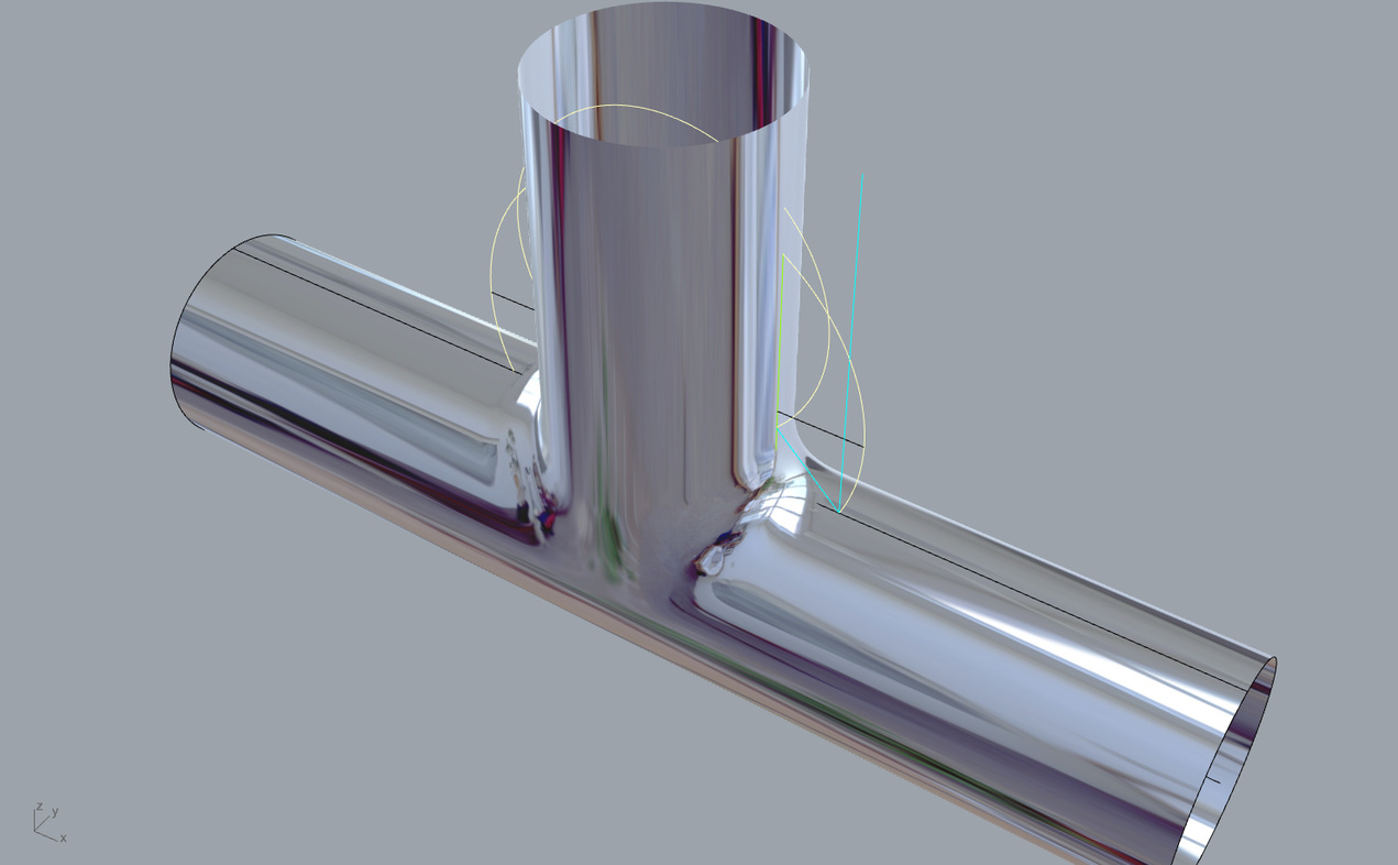

My take on this would be to BlendSrf from a double cut with circles, like so:
The bigger circle to cut the horizontal pipe, and the smaller pipe to cut the vertical pipe.
  1. Draw the bigger circle.
  2. Draw a 45 degree line from the uppermost quad on top of the horizontal pipe to get the intersection point for the upper circle on the vertical pipe (see 45º line).
  3. Cut then draw the smaller circle, then cut,
  4. then BlendCrv.
Done
Not perfect, but when good enough is good enough.

Well, perfect relates to the use case, but I tried to find a relation between all measurements that would give a Curvature continous blend without any hassle. I found that the following proportions gives good results:
Fig: Big circle radius = Pipe Radius * 1.75, and place the lower Osnap Quad exatly in the middle of the crossing pipes:
Edit: Use ~43º or less instead (see posts far below)
The draw the 45º 45º line from the intersection point of the pipe and the big circle. Then the smaller circle get a center point at the intersection point of the vertical pipe and the 45º 45º line, and extend its radius down to the point at the intersection between the 45º 45º line and the pipe contour. Then Trim the pipes, MergeAllEdges, and move seams to the 45º 45º intersections of both pipes, Blend with Curvature continuity on both pipes, and you’re done.
// Rolf

No, it’s not hidden,
… but now that I tried it again it seems like I reduced curvature to Tangency for one of the edges, then the sides were straightened out significantly:
// Rolf
Right, I tested it again. Only a slight improvement, but both edges on tangency seems to work best. Thanks.
Max.
Another way to straighten out the surface is to0 add “shapes” at the two places were it bends inward, and keep Curvature on both edges. Still not perfect, but better,
// Rolf
Tried that now, and yes, that looks best for the eye. :+1:

In the BlendSrf dialog, press Add Shapes and place two of them at the place were the surface tends to bend inwards. That will straigthten out the surface. Here:
BTW: I’m not a surface modeller. I spend 99% time on programming Grasshopper. But I find it interesting to try to solve tricky surface problems with the most redneckish attempts I can come up with.
Edit: I got good result even using G3 on the upper edge (1) after lowering the upper circle center to 43º instead of 45º (here using Zebra “Thinner” and mesh setting Max distance, edge to surface 0.02)
Edit2: And at 40º (up from horizontal) with a new cut of the upper pipe, I get a fairly “perfect” blend using G3 on both edges and two “shapes” placed at the sides, as described earlier:
