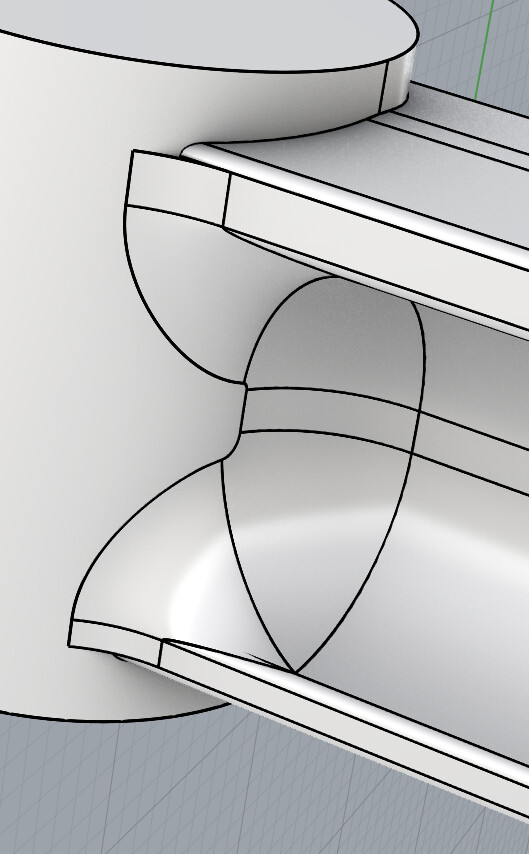

0.75 rad fillet bar to cylinder , all four places, yet FilletEdge fails, then explode and try for FilletSrf, it wont let me pick the bars surface, only part of it..
mergeSrf shows the surface as one, but FilletSrf says no it isnt.
I can never get on with FilletSrf as what appears a surface only sees part of it get selected then the next pick is the ‘mating surface’ so thats no use.

you won’t be able to fit 0.75 here, the upper radius is 0.629” and the lower is 0.703”
If you fit in a 0.6 radius, you could, with some manual intervention create it:

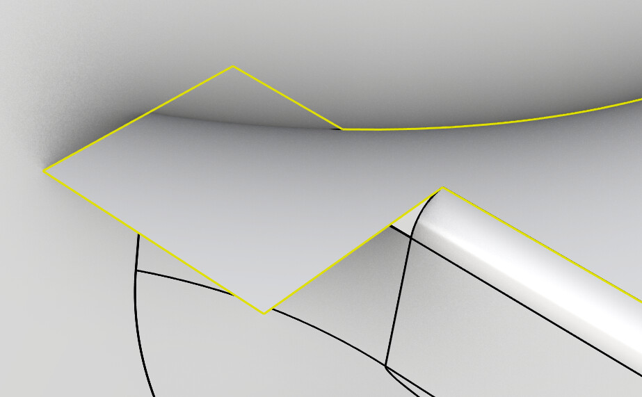

Delete the upper surface of the fillet chain:
Split the small fillet and delete
create a plane
Match it in the direction of the top surface
Extend the surface
Join and MergeAllCoplanarFaces with the top surface:
FilletSrf to 0.05:
btw there is a lot more going on in that file that needs fixing.
These kind of surfaces with singularities should be avoided:
Something like this could work for that area:
