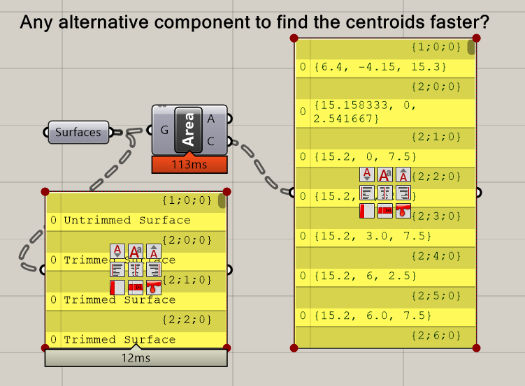

How about the Eval Surface component? Feed the surface in as input, right click " reparameterize". For the UV input feed in a text panel “.5,.5” this will give you the center point as output.

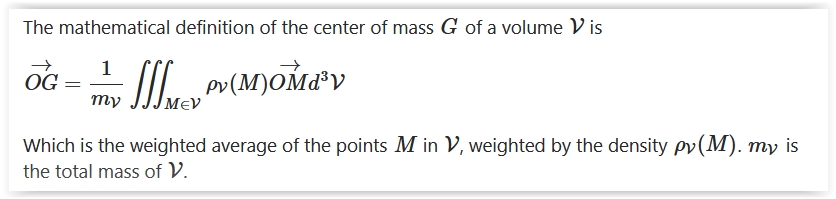

Oh true I guess area centroid is more akin to evaluation of a bounding box center point. Where as a surface center point could be very different especially on a concave curved surface for example
It depends why you need a center. Evaluate surface at 0.5, 0.5, 0.5 is usually good enough. Depending how you generated your sutfaces you may need to right click the input node and choose reparametrize, which shifts fhe domain of a surface to (0 to 1) which hopefully also shifts their halfway point to the middle.
If you need a better middle but not as taxing as the area node you could consider extracting the boundary curve of your surface and finding the center of that polycurve. Curve math will be quicker than brep math. You might even consider rebuilding those curves as five or ten point polylines before finding their center. That math sounds quite quick, but could takr troubleshooting . Test some things on a subset of yoyr surfaces so you can iterate quickly.
You might also consider finding the 0.5 0.5 0.5 middle via eval surface and then use pull geometry so that your point is guaranteed to be on your surface. Like i said, depends on what you mean by middle and what youre doing with this middle. Edit: sorry if im reiterating pieces of answers peter gave, his answers are always spot on. Edit 2 lol i guess i just reiterated both the thread answers typed while on a bus and didnt read thoroughly (:
