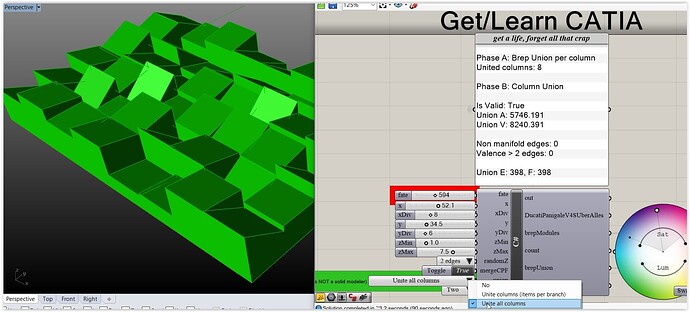

Easy (but a bit tricky) via code … rather impossible without. That said … keep in mind that Rhino is a Surface modeler … meaning that you should handle ALL “3d” ops with care (Karma a must).
  1. Do/sample your things in a Tree (say that in Y [“columns”] are the items and in X [“rows”] are the branches). Prior union your collection is :
  2. Unite all the 3d items on a per “column” (i.e. branch) basis (while merging all co-planar faces). Sample the unions in a unionList (Rhino can do that without issues - but as expected is S-L-O-W).
  3. From index 0 to unionList.Count-1, foreach pair (left [index] - right [index+1]) in the unionList remove the right BrepFace for the left and the left BrepFace for the right and get the 3dCurves (as crvLeft, crvRight). Create the bool diff (crvLeft, crvRight, tol) AND the bool diff (crvRight, crvLeft, tol). Get the Planar Breps and add’m to the unionList (as in 2).
  4. Join the Breps in the unionList.
Collection with right-left Faces removed:
Collection prior joining the Breps (reds are the things from bool diff in 3):
Anyway if you want an entry Level C# that does that notify.
