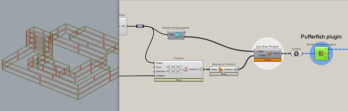

I’m encountering an issue with a Grasshopper script I’m working on. The goal is to generate simple windows (srf) on a façade based on an input geometry (extrusion or closed polysrf). The windows should be generated per storey.
While the script works fine with basic geometries, it fails as soon as the input geometry becomes more complex. For example, in the two attached cases (see grasshopper script), the Isotrim component doesn’t behave as expected or wished: the resulting window surfaces either overlap or extend beyond the actual input geometry.
I’d greatly appreciate any advice or help in resolving this issue!

Isotrim untrims its input faces :question:

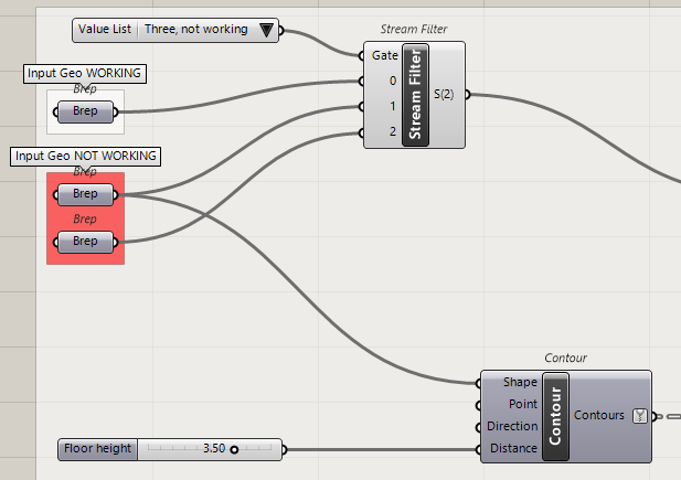

I see other issues in this code, like connecting one of the “NOT WORKING” breps to Contour instead of the output from Stream Filter?
Hi Joseph!
do you have a suggestion how I could solve the aforementioned issue?

Avoid passing trimmed surfaces to Isotrim ?
Split the unflattened list of surfaces from Split Brep Multiple?
You need to break down your surfaces from L shapes and what-not in to rectangles. Isotrim is working on the larger bounding rectangle of these surfaces, i.e. untrims them, as Joseph says.
Thanks! I’m looking for a solution - ideally without relying on external plugins like Pufferfish, as previously suggested (even though it works!).
However, when I try to apply your solution, I get an error (“splitting returned no results”). Could you possibly share a screenshot of your full setup? That would help me follow your approach more accurately.
PS: @Jospeh_Oster: I simply overlooked the misconnection with the Stream Filter. :wink:
Question_Facade_Isotrim_v0.1.gh (34.8 KB)
I’m not sure which of the changes I made are necessary but suspect sFace (yellow group) here is one of them.
Facade_Isotrim_2025May25a.gh (43.4 KB)
It is one line of C# I got on this forum years ago:
  private void RunScript(Brep B, ref object sB)
    B.Faces.ShrinkFaces();
    sB = B;
Unfortunately, the one that was working is now broken :bangbang: Haven’t delved into why yet. :thinking:
Grafting the output of sFace fixed things but had to add a filter (purple group) for surfaces that are are too small in Z due to contour alignment. (to fix an anomaly in the “working” brep)
Facade_Isotrim_2025May25b.gh (43.5 KB)
