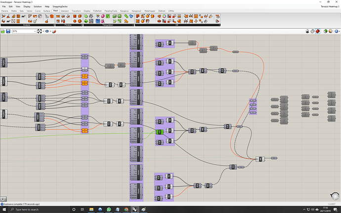

I tried to write a definition to contour a surface and create a ‘giants causeway’ with each contour packed with circles with different radii. It is admittedly a very clunky definition. Has anyone tried to do something similar? Have a play around with what i have written- it uses parts of the kangaroo examples that @DanielPiker published, and then some. I have also tried to run a galapagos solver on top of it to optimize it based on the difference between the sum of areas of the circles and the surface that they represent.
I havent yet found a way to make a more responsive version, and I feel that trying to limit the radius sets is part of the problem.

Hi Aditya,
Can you summarise the aim?
I see your definition has many separate solver components inside clusters - it’s usually good to have only one solver component on the canvas with all the different goals feeding into it.
If the intended result is different regions, each filled with circles of a specific radius, perhaps something like this:
circlepack_regions_radii.gh (15.6 KB)

Im now trying to rework your definition, to sync the different radii and regions, but it doesnt work for regions within regions? maybe i could just create w synchronous lists of regions and radii instead of splitting a base surface with curves?

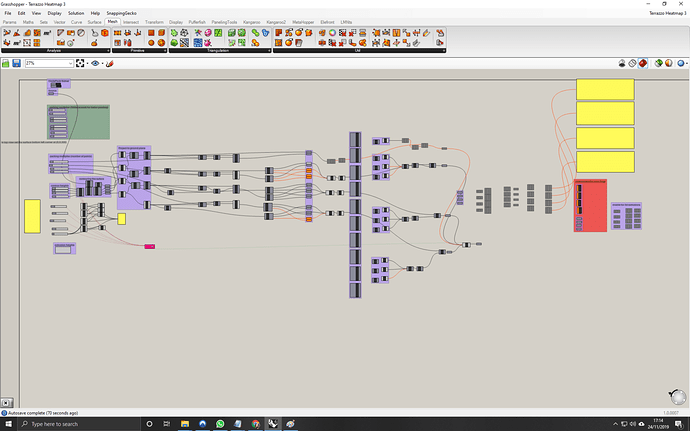

following up with larger rez images of the same def.
did you mean these subtraction components? this is actually to try and create a fitness criteria for galapagos to test.
I thought that it would help to minimize the difference between the sum of areas of all the circles and the region im trying to pack with them.
Even with a “magnifying glass”, it’s hard for me to see those components clearly, and it won’t show missing components inside of clusters anyway. Frankly, it’s too much work for me. Enjoy.
Regions within regions shouldn’t matter here - as long as you have one outer curve, it is making a surface from this outer one and splitting it with all the interior ones
