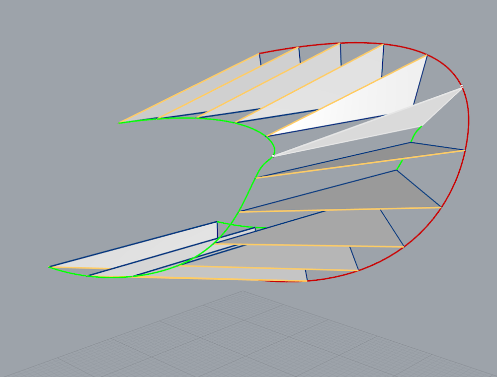

In the attached example ExtrudeCrvTapered produces a polysurface with overlap. The extruded curve is smooth with no problems. ExtrudeCrv and ExtrudeCrvTapared produce simple surfaces.

Hi David- I see that… offsetting the curve, which is what is involved here, gets uglier the farther the offset, so eventually, it is not surprising if a kink develops, but in this case simply offsetting the curve to the amount used in the taper returns a different curve- cleaner, so there is something else going on with generating the end curve for the tapered extrusion that I am not aware of, I’ll see if the developer can shed any light on it. Straight and ToPoint extrusions do not need that ending curve to be made, so they retain the input curve structure.
I know that ExtrudeCrvTapered and ExtrudeCrvtoPoint produce different results. The problem in this case is ExtrudeCrvTapered resulted in a polysurface with the two individual surfaces overlapping over the entire length of the extrusion. This is a bad result given that the starting curve is smooth…
Hi David- you may end up, eventually, depending on angle and distance, with a polysurface from even a smooth input curve. For example, extrude an ellipse, even an rebuilt one, that is degree three and G2 internally, with ExtrudeTapered. Eventually that will make a polysurface, because the offset of an ellipse, if you take it far enough, has kinks in it. However, your example looks to me like it should not be at that point yet.

when you offset the curve in the direction you have, the curve kinks.. basically, the command is offsetting the curve, then moving it, then lofting between the two curves..
you can however dupEdge the ‘new’ curve created via the Taper (well, there’s two of them), join them, then loft between the original result and get a surface instead of a polysurface so maybe there is some sort of error happening?
[EDIT] oh wait- nvrmnd.. i had _CreaseSplitting turned off on this computer.. if i _Loft the curves with crease splitting on, i end up with the same surface as the extrudeCrvTapered version.
I agree that kinks can occur if the taper is long enough. However in this case the problem is occurring when the taper is short enough that the curve doesn’t kink.
There is some sort of error occurring. The edge at the other side of the bad polysurface from the starting curve is not the same as a curve with constant offset. The amount of offset varies.

The offset should be 4.64072. Offset the starting curve by that amount. The result is a smooth curve. Move the offset curve to the same position as the small end of the taper. Note that the offset curve does not match the polysurface from ExtrudeCrvTapered. Loft between the starting curve and the offset curve with straight sections. The result is a smooth single surface without overlap.

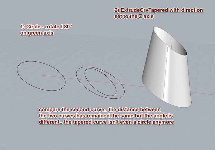

just an example of what happens when you use the command on a planar curve but in a direction that isn’t perpendicular to the plane…
your example is doing this plus, it’s not planar either…
i really don’t think the offset curve when using ExtrudeCrvTapered can be the same result as an _Offset curve at a constant distance… (if it were, this example would be a circle inside a circle)
As I said above, the offset is normal to the direction of the tapered extrusion as well as to the curve. For a planar starting curve the offset curve is not in the plane of the starting curve. So a tilted circle will not result in a circle as the offset curve. Also the end of a tapered extrusion with a tilted starting curve will be a different angle than the starting curve.
if you taper perpendicular to a 2D circle then yes, the offset will remain constant & on the same angle.. draw a circle on the XY plane then taper it vertically.. you’ll end up with a circle inside a circle..

ha.. right. that’s what the drawing i posted earlier shows.. we’re saying the same thing :smile:
right, i understand what you’re saying here as well.. using your drawing as a basis, that same triangle formed from the offset&move (or however it should be called) can be placed perpendicular at various points all along the original curve.. (meaning- the extrusion distance and the angle are being maintained)..
something like this:
right?
so, i guess you’re saying that ExtrudeCrvTapered is failing to do that?
