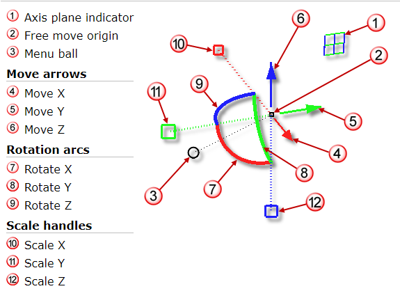

Extrude both sides with axis plane indicator in gumball
I used to be able to do this on Rhino 7, and can not find a way to do it on rhino 8
Select an curve or edge, press CTRL+shift and drag the axis plane indicator in the gumbal to any direction, this resulted on a surface being extruded in both directions both also free to be oriented (not only on to the gumball arrow)
does anyone know if this is a setting or how to do it now?
Ref picture and video

Hi @Uriel_Soto ,
In Rhino 8 you can do the same using a single axis scale handle with Shift+Ctrl, will that work for you? I don’t see a difference in the result here on curves or SubD edge loops.
Hi Brian, I think the freedom to choose the direction of the extrusion is a relevant part of the problem here…
If Shift is held the direction is from the origin uniformly. Maybe I’m missing something?
Hi Brian,
Actually the issue is about extruding a curve or edge into a surface, both directions, using the “axis plane indicator” or waffle, this was possible in rhino 7 but apparently not in rhino 8
I think shift should make the extrusion go to both sides.
Currently shift scales the edge which to me deos not make sense if ctrl is pressed at the same time
Can you post a file with the exact steps to perform please? I see no difference using the single axis scale handle with Shift+Ctrl on a curve or surface edge in v7 and v8. I do see that the 2 axis handle allowed this on curves and SubD edges in Rhino 7 but did not allow it on NURBS Surface edges and the same is true for v8.
We aimed to simplify many of the keyboard combos and order required on GB shortcuts in v8 and if there is functionality lost we’ll try and fix/restore that. If using the single axis handle with Shift+Ctrl does the same, can that work for you? Again, if I am missing something I am open to understanding more. A file and steps to compare in v7 versus v8 will help.
