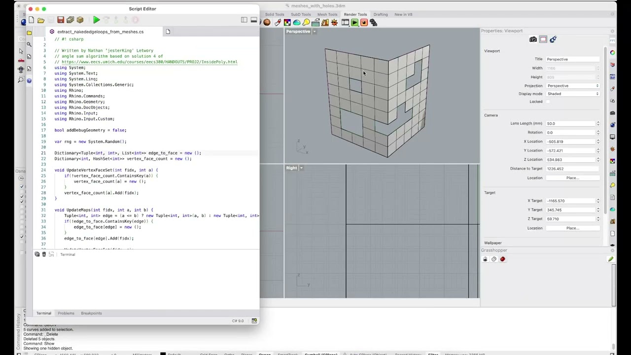

Dear McNeel,
Is it possible to extract inner naked (hole) lines, of a mesh via Rhino3dmNET library?
I would like to extract the blue colored lines:
I tried converting the mesh to a brep (Brep.CreateFromMesh), but without success. The mesh is successfully created to a brep, but then Brep.DuplicateNakedEdgeCurves simply threats both outer and hole naked edges as the same:
Running Brep.MergeCoplanarFaces before Brep.DuplicateNakedEdgeCurves - would solve the issue, but sadly that method does not exist in Rhino3dmNET.
At the moment, I am finding the longest naked polyline - and stating that: this is the outer one.
And all others are inner naked (hole) polylines.
I am an interested if there is another way, to extract the mesh holes? Maybe with a “topological” approach, instead of upper: longest polyline approach?
Attached is the mesh
holes.gh (22.1 KB)

Something like this should work in rhino3dm (thanks to @DavidRutten for the tip). You will have to decide how to filter out the outer edge loop.
        // mesh = your mesh
        var edges = new List<Curve>();
        for(int i = 0; i < mesh.TopologyEdges.Count; i ++ )
            var faceCnt = mesh.TopologyEdges.GetConnectedFaces(i).Length;
            if(faceCnt == 1)
                edges.Add(mesh.TopologyEdges.EdgeLine(i).ToNurbsCurve());
        var result = Curve.JoinCurves(edges);

A couple of weeks ago I started typing a short C# script using topology edges from meshes. Other things got in the way, but let me post what I had cooked up thus far:

This script adds lines where naked edges are found. Next up was going to be to determine inner vs outer edge loop, but that is where I had to stop for the moment.
Perhaps winding could be possible if you could find a plane to project edge loops and mesh face centers to. Then take a face adjacent to an edge and do a winding count. Essentially see if the face center is outside of the loop or inside of the loop. Inside of the loop would give you a full circle when summing angles of all edges, meaning it would be the outer loop. Otherwise it is an inner loop.

@djordje ok, so I have now finished and cleaned up the C# script somewhat.
I don’t know if exactly everything is in rhino3dm (any of Python, JavaScript or .NET), but I think it should give you some idea. Here a quick recording of it working:
And the code
// #! csharp
// Written by Nathan 'jesterKing' Letwory
// angle sum algorithm based on solution 4 of
// https://www.eecs.umich.edu/courses/eecs380/HANDOUTS/PROJ2/InsidePoly.html

    // whether they represent an outer naked edge loop or an inner naked
    // edge loop.
    int loopidx = 0;
    foreach(HashSet<int> loop in loops) {
        List<Curve> crvs= new();
        MeshFace mf;
        Point3d pp = Point3d.Unset;
        foreach(int dei in loop) {
            Line l = m.TopologyEdges.EdgeLine(dei);
            int[] conn_faces = m.TopologyEdges.GetConnectedFaces(dei);
            mf = m.Faces[conn_faces[0]];
            if(pp == Point3d.Unset) {
                if(mf.IsQuad) {
                    pp = Point3d.Divide(
                        m.Vertices[mf.A] + m.Vertices[mf.B] + m.Vertices[mf.C] + m.Vertices[mf.D], 4);
                else {
                        m.Vertices[mf.A] + m.Vertices[mf.B] + m.Vertices[mf.C], 3);
            crvs.Add(l.ToNurbsCurve());
        // there should be only one curve here, add checks if you think this is too dangerous
        Curve joinedCurve = Curve.JoinCurves(crvs, 0.0001, false)[0];
        // finally figure out if this is that outer or inner naked edge loop.
        bool isouter = IsOuterNakedEdgeloop(joinedCurve, pp);
        // add to the document.
        ObjectAttributes oa = new ();
        oa.SetUserString("outer naked edge", $"{isouter}");
        oa.ColorSource = ObjectColorSource.ColorFromObject;
        oa.ObjectColor = isouter ?
                    System.Drawing.Color.Purple :
                    System.Drawing.Color.DarkGreen;
        __rhino_doc__.Objects.AddCurve(joinedCurve, oa);
        loopidx++;
/// <summary>
/// Determine if given curve represents outer naked edge (true) or inner naked edge (false)
/// The point pp is the centroid of a mesh face.
/// The algorithm used here is sum of angles, which determines if pp is inside the curve (outer naked edge loop)
/// or outside the curve (inner naked edge loop)
/// </summary>
bool IsOuterNakedEdgeloop(Curve joinedCurve, Point3d pp) {
    // angle (sum) we calculate
    double angle = 0.0;
    // explode joined curve into its subcurves, then find
    // all start and end points. Points we use to fit a plane through.
    Curve[] crvs = joinedCurve.GetSubCurves();
    HashSet<Point3d> pts = new ();
    foreach(Curve c in crvs) {
        pts.Add(c.PointAtStart);
        pts.Add(c.PointAtEnd);
    // Find a plane through our edge loop points. Use this to project the joined curve
    // and the initial mesh face point to.
    Plane plane;
    PlaneFitResult fitres = Plane.FitPlaneToPoints(pts, out plane);
    if(fitres == PlaneFitResult.Success) {
        Line extra = new Line(pp, crvs[0].PointAtStart);
        Curve projectedExtra = Curve.ProjectToPlane(extra.ToNurbsCurve(), plane);
        Curve projectedCurve = Curve.ProjectToPlane(joinedCurve, plane);
        if(addDebugGeometry) { __rhino_doc__.Objects.AddCurve(projectedCurve); }
        if(addDebugGeometry) { __rhino_doc__.Objects.AddCurve(projectedExtra); }
        Curve[] projectedSubCurves = projectedCurve.GetSubCurves();
            foreach(Curve pc in projectedSubCurves) {
                Line _l = new Line(projectedExtra.PointAtStart, pc.PointAtMid);
                __rhino_doc__.Objects.AddLine(_l);
        // the actual point we want to check - the projected start point which is the projected meshface mid point.
        Point3d q = projectedExtra.PointAtStart;
        int n = projectedSubCurves.Length;
        double m1 = 0.0;
        double m2 = 0.0;
        double costheta = 0.0;
        for(int i = 0; i < n; i++) {
            Vector3d v1 = projectedSubCurves[i].PointAtStart - q;
            // note, fetch next curve, or wrap around to first
            Vector3d v2 = projectedSubCurves[(i+1)%n].PointAtStart - q;
            // determine angle between the two vectors,
            double _a = Vector3d.VectorAngle(v1, v2);
            angle += _a;
    // We have an outer naked edge if the angle sum equals 2*pi.
    return RhinoMath.EpsilonEquals(angle, RhinoMath.TwoPI, 0.000001);
extract_nakededgeloops_from_meshes.cs (7.4 KB)
