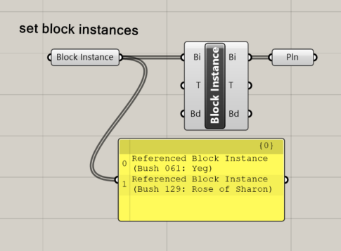

Hello @Andy and @Japhy, I wonder if this has changed in recent versions, as the plane output is no longer in the model block instance component. My build is Rhino 8 SR12 2024-10-8 (Rhino 8, 8.12.24282.07001)
My workaround was to append a plane and then point to the block instance reference, which did the trick, but I wonder if I am missing something else.
Many thanks for your support.
Chris.
Nothing has changed but you can cast the transform output into a plane and that should work just fine
In Rhino 8, Grasshopper - Rhino Toolbar - Model Pane - Block Instance
there is no “Plane” on the component Model Block Instance, did I miss something ?
The transform output shows the plane
