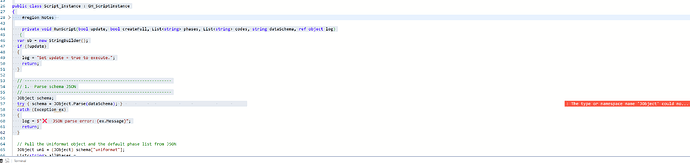

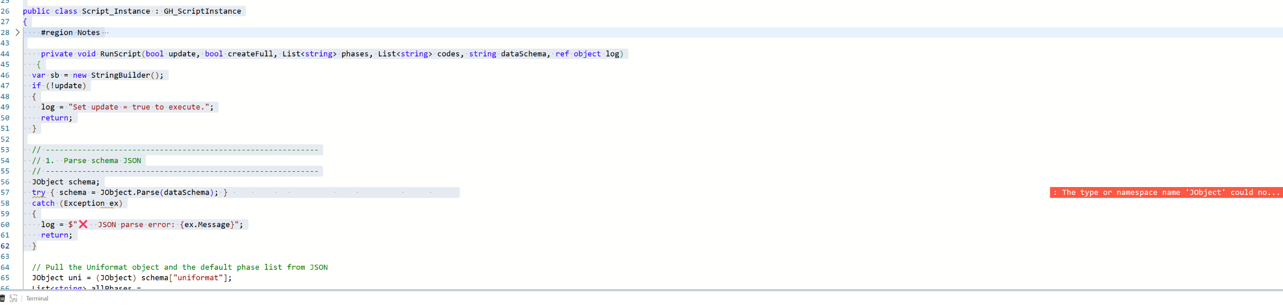

I’m trying to get a quick script to work that uses a JSON file. I ended up just swiching to visual studio for my other project because it needed to use json data and schema and I don’t htink I ever got this to work.
// Grasshopper Script Instance
#region Imports
#r "Newtonsoft.Json.dll"
#endregion
#region Usings
using System;
using System.Linq;
using System.Text;
using System.Collections;
using System.Collections.Generic;
using System.Drawing;
using Newtonsoft.Json;
using Rhino;
using Rhino.Geometry;
using Rhino.DocObjects;
using Grasshopper;
using Grasshopper.Kernel;
using Grasshopper.Kernel.Data;
using Grasshopper.Kernel.Types;
#endregion
public class Script_Instance : GH_ScriptInstance
    #region Notes
      Members:
        RhinoDoc RhinoDocument
        GH_Document GrasshopperDocument
        IGH_Component Component
        int Iteration
      Methods (Virtual & overridable):
        Print(string text)
        Print(string format, params object[] args)
        Reflect(object obj)
        Reflect(object obj, string method_name)
    #endregion
    private void RunScript(bool update, bool createFull, List<string> phases, List<string> codes, string dataSchema, ref object log)
  var sb = new StringBuilder();
  if (!update)
    log = "Set update = true to execute.";
    return;
  // 1.  Parse schema JSON
  JObject schema;
  try { schema = JObject.Parse(dataSchema); }
  catch (Exception ex)
    log = $"❌  JSON parse error: {ex.Message}";
    return;
