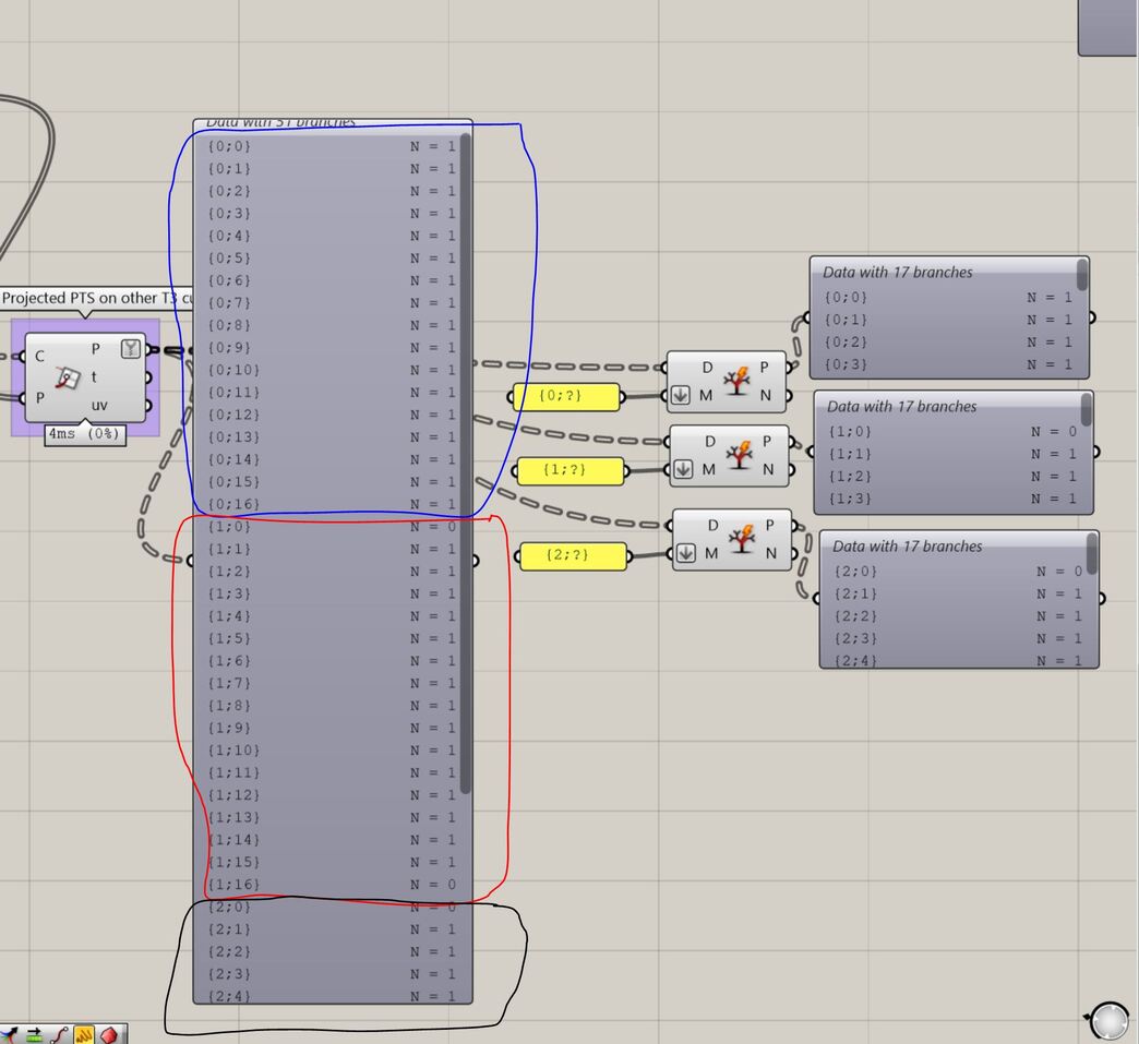

Is there a way to explode a tree by the first branch number and maintain the tree structure after? I feel likes there should be an easy solution but cant seem to find it
You can use [shift paths] component with -1 as input, or you can use [Path Mapper].
Another name for what you are doing could be to “merge innermost branches”.
Look here for more info:
Thanks for the reply but i dont want to merge the branches. I dont need to trim the tree.
what I am looking for its to isolate each branch as an output.
It may sound counter-intuitive but the whole “Bang!” component is counter intuitive requires continuous “Match Outputs” whenever the tree size changes.
You can call individual tree branches like below:
