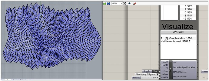

Anyway … Euler/Hamiltonial paths in graphs are one of the most challenging tasks known to man (if we want a solution in less than a week). If the EulerCycle thingy doesn’t work AND you can’t code (level required : expert) I would suggest to go after some other task. See Ham cycles using Meshes as Graphs.
And one in a rnd prox Graph:
That said 99% of the Internet solutions posted are out of question (N factorial : why bother talking?)

Well … thst’s kinda saying that a Harley Davidson is a motorcycle. I mean a Ham path/cycle algo should work (if there’s a solution anyway) on ANY valid Graph. So your thing is … er … hmm … some other thing.
That said your C# for the prox pairs … well … that’s another quite hard task: imagine trying to find the “best” prox pairs. In order to get the gist of what the issue is do a graph that displays the distances … and attempt to make it “as even as possible”.
Kinda a Steiner Graph pairs problem.
Anyway … you don’t need “best” prox pairs for a Ham cycle so don’t bother with that one.
How to start? Get a Graph, do the VV Connectivity, find possible islands (general case) using SOLELY the VV (and some Recursion) and “reorder” the VV using obviously 2 dim paths. Any “isolated” VV means a classic Adjacency Matrix: the only thing that a Ham cycle solution needs (assuming that the cost is not an issue for you).
How to end? In order to be pragmatic you should avoid any N factorial algo: this means advanced heuristics, so to speak.
Tip: what about a TSP thing? Or a PMST? (both are far easier to deal with).

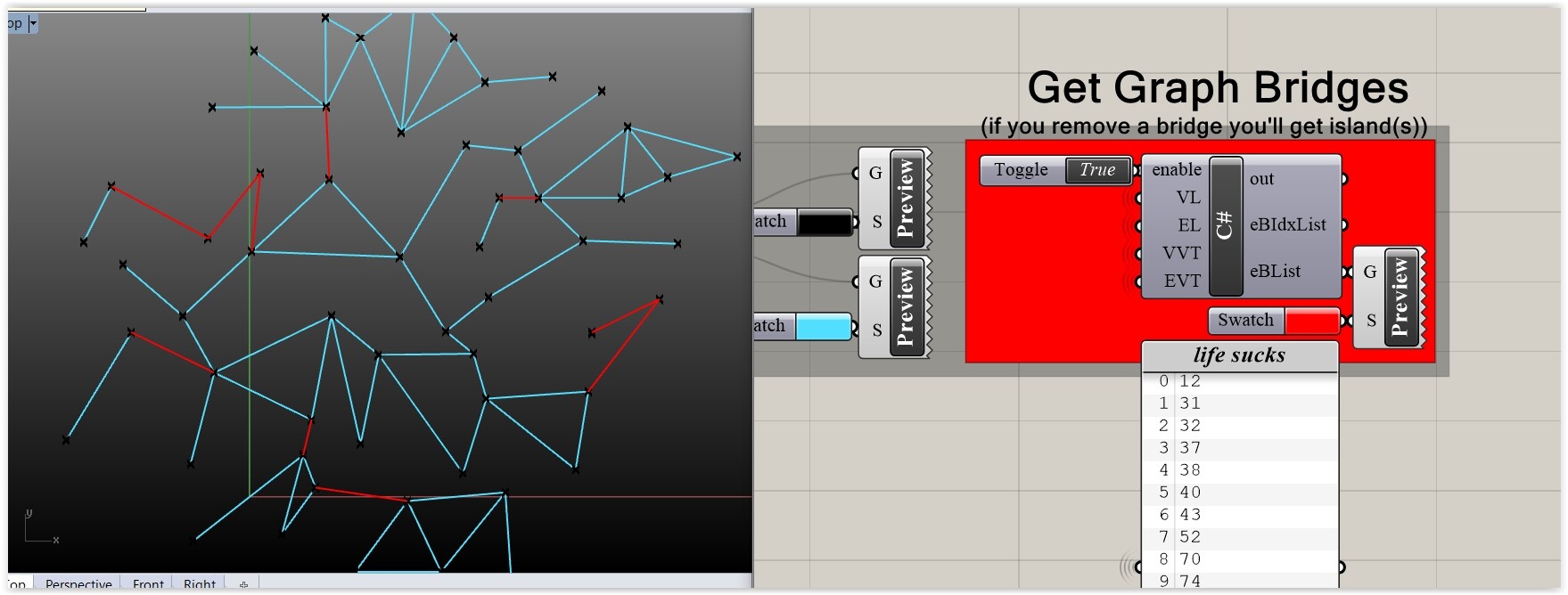

This is rather a very simple paper to follow. Also is very easy to write a Method that tells if an Edge is a Bridge (*). So given a Mesh, the Mesh TopoV, TopoE connectivity Methods available in R SDK (thus the related VV, VE, EV Trees AND the Bridges) … blah ,blah. Plus during the search a “cross” check Method based on neighbor indices intersections maybe could cut the mustard.
(*) Like:
And in case that you think that the right most result is wrong:
