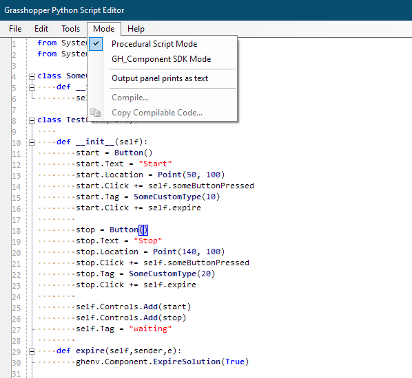

I test it and it work fine , but still i don’t figure out how to compile ghpy component with windows form.
I always have a problem with ghenv.Component.ExpireSolution(True) and can’t get the data from the form.

Thanks @nathanletwory , i appreciate your help.
Yes my first question is general و and when i get the answer than i try to make it work with windows form.
Right now i create this but something is missing , looks like the connection lost between the form and the component.
Maybe someone have an idea how to fix it
