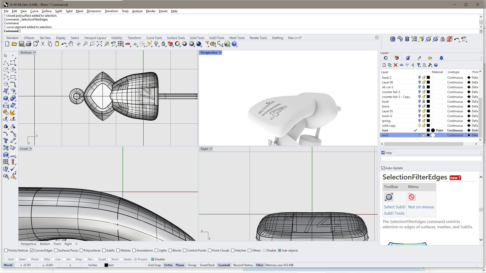

I want to engrave “1/4” into this surface. I want the text cut out and not raised.
I have projected the text lines to the surface, what would be the next step? or is this the wrong way to do this?
Hi David - this takes a few steps and is extra awkward on a SubD-derived object where there are multiple faces that get cut. If you can post a file with the objects in it here (public) or send to tech@mcneel.com to my attention, with a link back here in your comments, I’ll show a workflow that should be reasonable to execute…

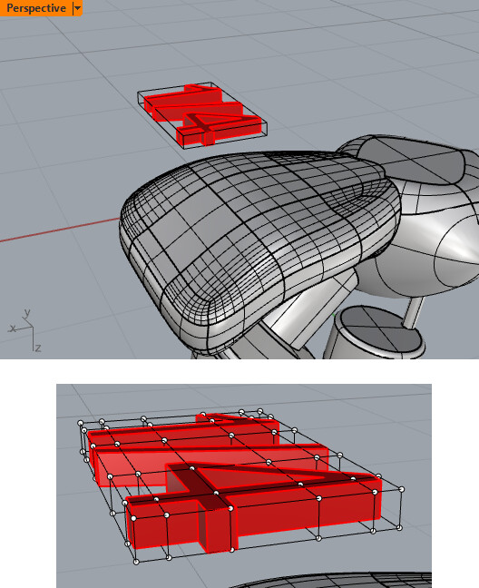

CageEdit your text solids all together with a bounding box cage. Set the Z points to 2, X and Y 4-6 points in this case - you’ll end up with something like this:
In an elevation view, window select points lioke so and move them with the gumball, down into the target object.
Carefully adjust the rows of points - always window select to get all - eventually you may want to switch to the front view to fine tune. Note this version leaves the verticals vertical - not necessarilty what you want.
Another way is to cage edit the text with a single surface - this will allow the verticals to orient themselves ‘correctly’ as the text wraps - I’ll include an example of each. Seems to me the secoind way is probably better in this case
