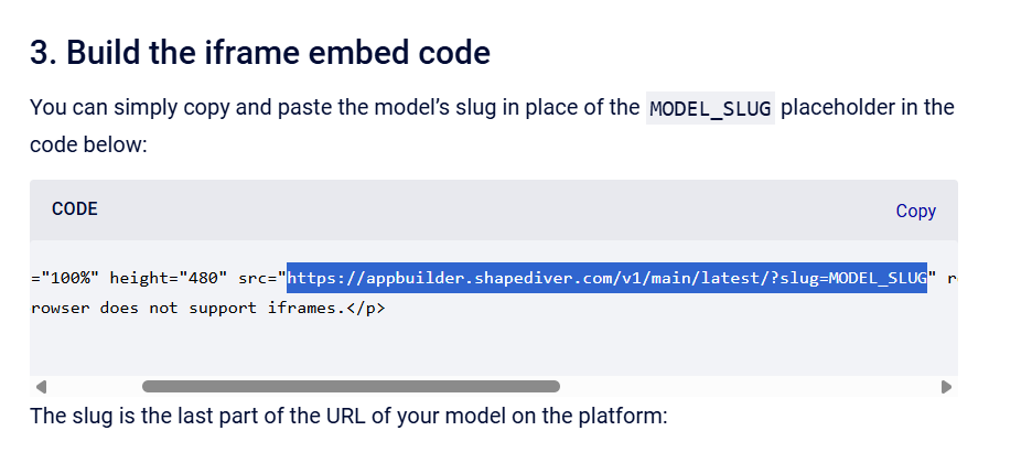

Please use the URL specified in the documentation article I sent above:
This will embed the App view.
