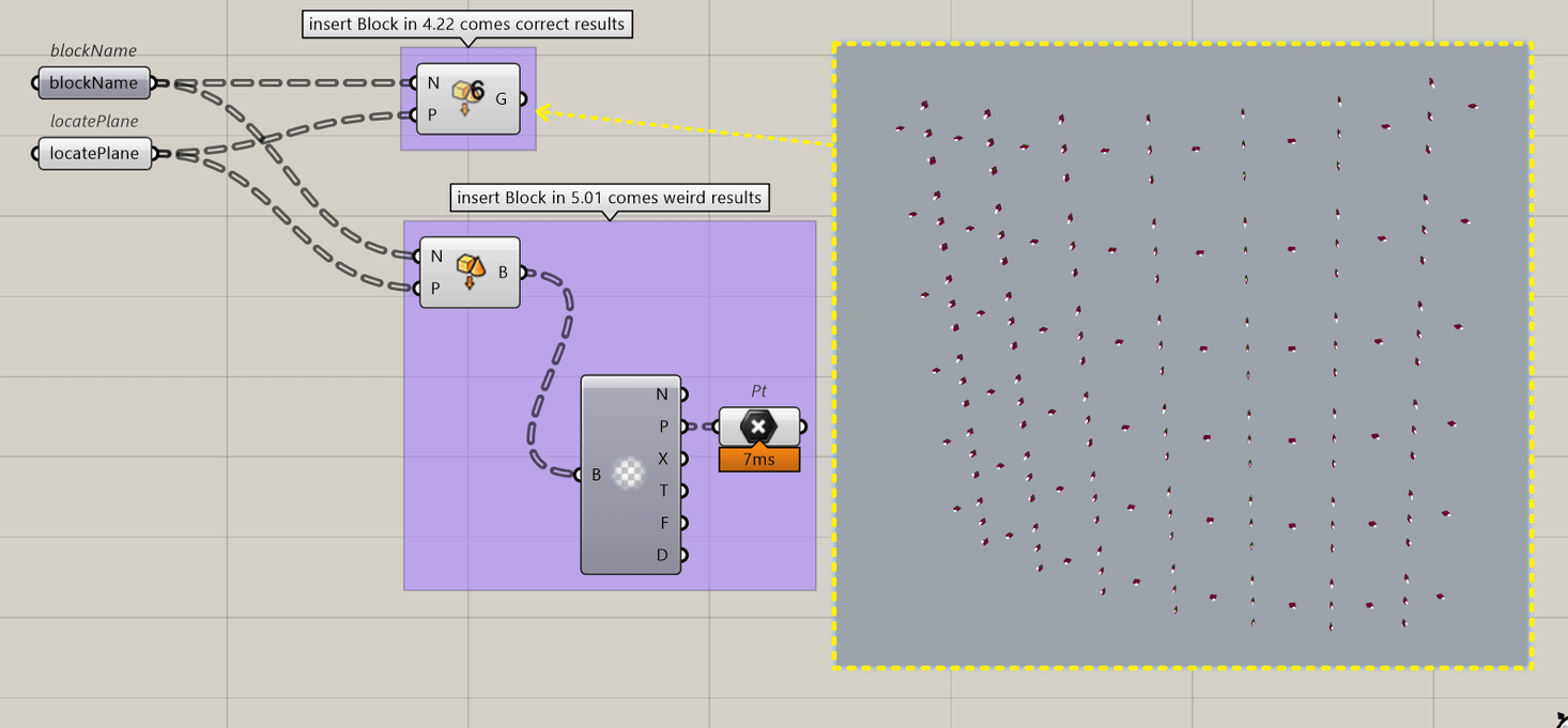

For the block manipulation functions, I got an issue for the " insert Block" component for it seems to insert blocks into wrong weird places, please help to make notes and check.
Following is the GH file for you kindly to check.
[comes correct results in 4.22]
[but weird in 5.01]
Elefront-500_issue_insert block.3dm (932.2 KB)
Elefront-500_issue_insert block.gh (297.0 KB)

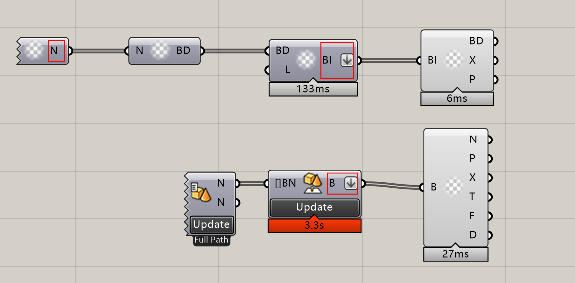

I suppose deconstructing blocks can be further cached.
And it seems referencing block by names is very slow.

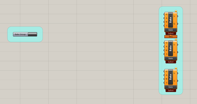

Sure, completely understand, we do the same. I added the “Bake Group” component to try to address that issue, so that you can trigger one or multiple Bake components from elsewhere on the canvas:
But I can see how this could become quite annoying if you have lots of Bake Components on the canvas and don’t want to have to create a group for each one.
Seems that I underestimated how important the toggle input was, so I’m happy to put it back. These are the kinds of things we only find out through feedback!
Thanks for the response. The Bake Group option is actually quite good. Could the Bake Group button be defined as keyboard shortcut? My definition requires Metahopper.

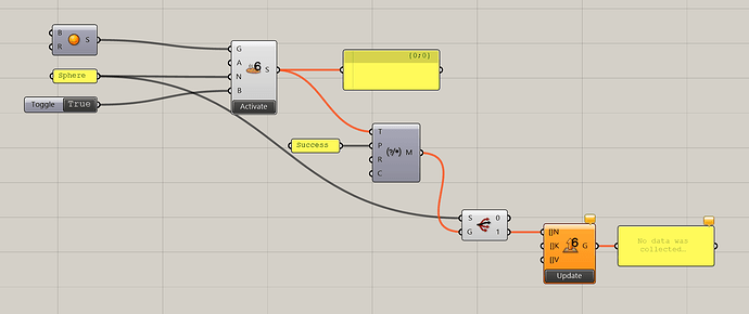

What always helps in these cases is to have another boolean output or even a string with a status message. If for example there is a success boolean output, you could use that to trigger something downstream. Similar to when you create a layer using GH, it actually outputs the layer name again, but only once the layer is actually created, so if you then bake to that layer in the same cycle, you are sure the layer is there.
Wouldn’t something like this work? Unfortunately, there appears to be no status message. Is there only a status message if there is an error? I think there should always be a status message, even when it is not doing anything, so there is no empty output.
reference_after_bake.gh (8.5 KB)
Yeah I think this is probably true, so we’ll leave it to the user!

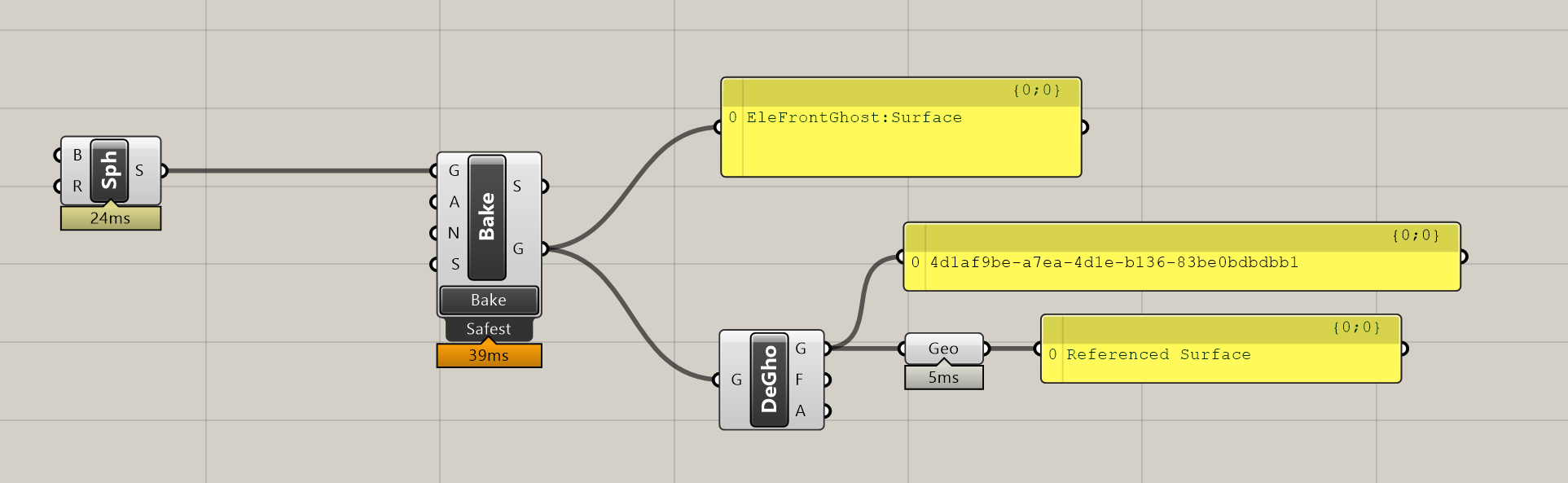

In terms of the specific example with re-referencing baked objects, for v5 we actually return the objects themselves after baking, so you don’t need to re-reference the components (another attempt to try to keep Rhino + GH sync’ed). They are returned as Ghost geometry, so that it doesn’t eat up memory by bringing the geometry back in, unless you need it, in which case you can get the Guid.
Okay, now that is even better. So in the new plugin since you have a way around the issue, you might as well add the boolean back in for the bake, right? The Ghost geometry will only be output once the bake is complete I would assume!?
