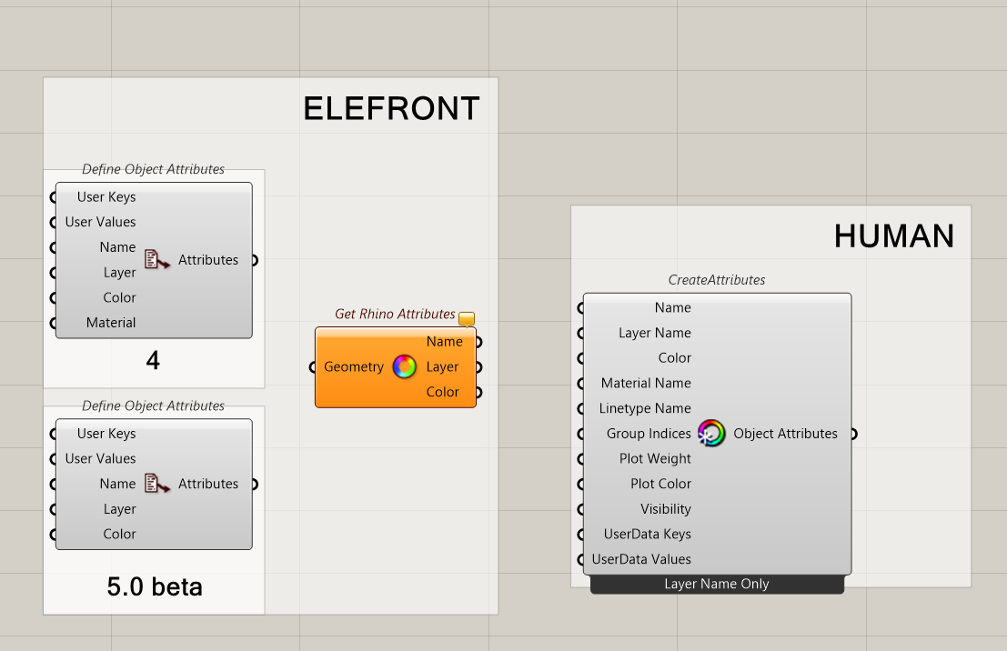

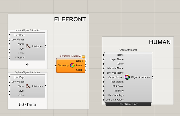

This is a big wish. In the past, many times I had a dilemma if I should use Human plugin or Elefront. Elefront, unfortunately, has fewer attributes supported, but I prefer the Elefront way of baking. Also, Human plugin is no longer developed.
Is there a chance that Elefront will support more attributes?

Hi @Czaja we will look into this for the future. As we make this for ourselves we never really use those features in our work, however I can see the value it has to others. Our primary objective is to iron out the major bugs, then bring feature parity to the previous release. After that, we will look into adding additional features. Point well noted!

  2. Material attributes from “Get Rhino Attributes” - It would be better if it’s added in the outputs. Also it’s missing in the deconstruct attributes, unlike in Elefront 4.

Hello - yeah, Materials haven’t really been implemented anywhere in this release just yet. It’s at the top of the list.

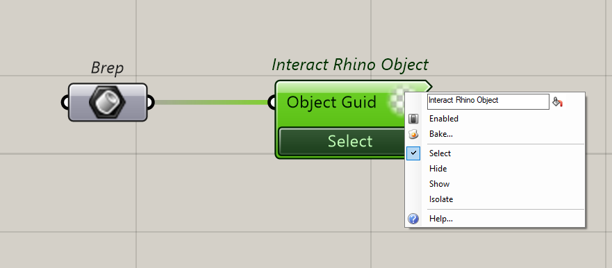

Interact Rhino Object component could solve the problem from the first post:
The same as in Bake Objects component there is no wire input to trigger the component, and also we can’t feed the type of action (Select, Hide, Show, Isolate) other than from the popup list.
Buttons and popup lists with options are elegant, and handy to use most of the time, but sometimes wire input is needed.
Do you think that adding Deselect option would be possible?
