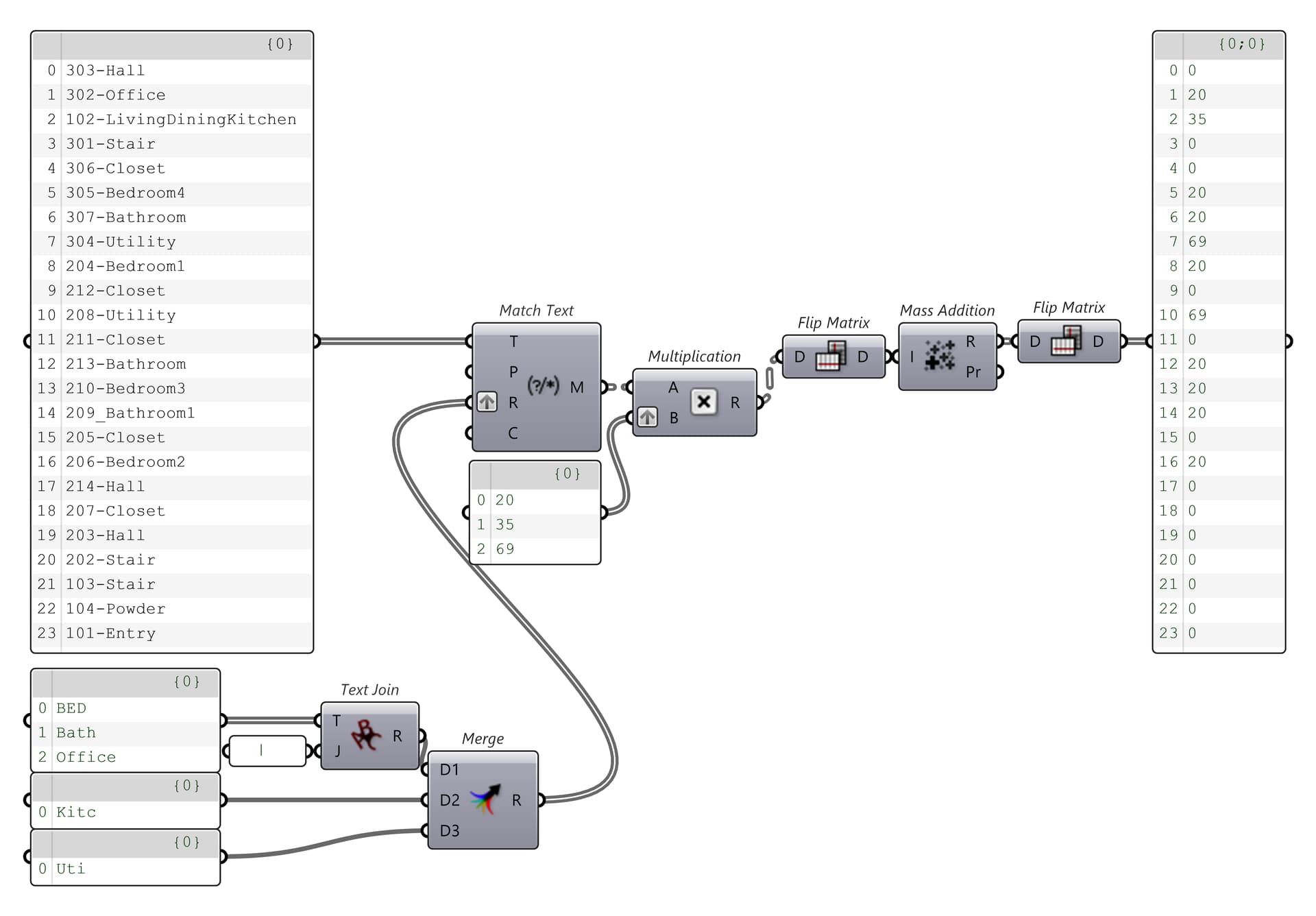

Easy one? Collapse branched list back into one if certain value
A bit embarrassing to stumble here - I performed some text find/replace and am trying to recombine all modified values back into a single list {0,0}. Undetermined unique values to initiate the text search, so I think avoiding explode/entwine is wise - I think.
What’s the last step? Or a more elegant solution? I seem to have a lot of juggled Grafts and Simplifys early on.

Thanks for looking into it! I’m sorry, I should have been clearer. The panel at right is the desired result (I just typed it into the panel directly):
Anon.gh (15.7 KB)
I never would have thought to use multiplication on booleans, then mass addition with flip matrixes.
