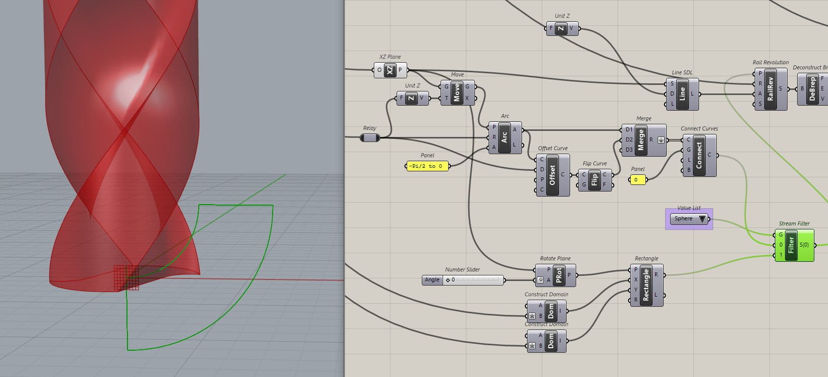

I think you need to go Solid Boolean for this
What I would do is to draw a 2D section and Revolve it, then use it as solid for boolean subtraction
for instance, if it’s a spherical end I would first draw a quarter circle and offset/connect it to get this:
then use Revolution around the Z axis to make it into a solid (here I’m using Rail Revolution because I’m having some troubles with standard Revolution component, but as I’m providing a Circle as guide Rail, the result is the very same)
this is how it looks after Solid Subtraction:
for a sharp end on custom angle, I guess you can use the very same method but change the Revolved section into something like a rectangle, like this:
you could first rotate the XZ construction plane by an angle, then build the very same rectangle over it, which results in this solid using for subtraction:
the Value List help organizing the flow, so you can chose between sphere and rectangle section
now that I see it, I believe the radius of the spherical-tip is not the very same radius of the tip :slight_smile: so with this slider you can change it:
Drillbit_TIP_inspiration.gh (29.7 KB)
