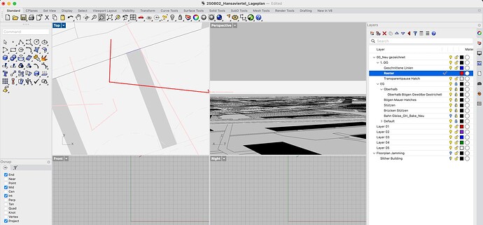

I’m drawing a siteplan for an architecture project. I want to produce a drawing for different levels on top of the ground level. Very sadly, Rhino doesn’t have a transparent overlay mode like ArchiCAD or Vectorworks have, so I’m trying to build a workaround:
  • Base drawing is on floor level 0.00.
  • I created a new Cplane +15.5m above
  • In a new layer above the base layer I drew a transparent white hatch on the new CPlane which I use to control how strong I can still see the base layer.
  • Now, newly drawn Curves are being sorted/displayed behind the hatch, despite being in a layer above and even when moving the white hatch -1m lower, the hatch still is shown above my Curves.
  • only BringToFront after I have drawn the Curves brings them in front of the Hatch which makes my DIY transparent mode not really feasible..
Is this a bug? I would assume that a newly drawn curve in layer above the hatch (which is actually now -1m lower) should also be displayed on top of the hatch and not underneath..
Here’s a video of the issue:
Even when the black line is moved several meters above the hatch, it’ still being displayed underneath the hatch, even though the hatch has been SendToBack.
Only selecting the curves and BringToFront actually brings them to the front. It would be great to fix this issue (or tell me what I’m doing wrong) so I could work with this workaround for a Transparent Overlay Mode..

But if I had to guess, it might be one of two things:
  1. Limitations of the Video card ZBuffer. This can happen if the groundplane is very large and then the curve and stuff is zoomed quite far in. The large baseplane image sets the Zbuffer to be quite large in size and that leave as little detail to sort objects in the screen. Typically zbuffers have 256 levels they can sort. The Zbuffer sorting is video card related, so seeing systeminfo here would help.
  2. Less likely, but possible far from origin problem? How far from origin is the curve? I run Analyze point and snap to an endpoint to determine that.
Looking into how to do a transparent overlay would be interesting to look into also.
Can you explain how you use a transparency overlay? For what purpose of workflow?
Generally to create transparency overlay in Rhino use layer transparency. That could be extended to a linked insert.
But, I see that there is some difference with the way Hatch transparency works specifically when compared to surfaces. This I need to report to see how that is supposed to work.

So, draw order is generally layer based. So the top layers will draw over the lower layers. This also counts for the blocks that are inserted on certain layers.
The example model here shows how that works and I hope we can use it as an example of what you are trying to do.
Locking layers allows them to be visible, snappable but not selectable. In Display options locked objects can be automatically faded with color transparency and draw behind other objects. Would those settings work in this case?
Another way, but I am nto sure neccesary is Layer color can be changed to transparent colors. So potentially this could be used to fade out certain lines so they fade into the back, but still can be snapped to.
faded background.3dm (657.9 KB)

thank you for the time you took. I’m in the final weeks of my MA project, that’s why I haven’t found the time to investigate it further – I worked around it but will come back to it, but I think the problem stems from something related to this… drawing order in blocks…
The issue that I cannot wrap my head around is the drawing order inside of Blocks. For example, I have many blocks and nested blocks. In my understanding the drawing order should follow the respective layer position. It appears to me that when the objects are inside a block, which I created on the separate layer “Blocks” the newly created hatches (on layer “Hatches” below the layer for the outlines) are being displayed above the outlines – despite layer order suggesting the other way round..
The screenshot shows two blocks of a column clipped in plan. In the left block, the lighter net hatch is being displayed above the outline. In the right block I moved the hatch to the back with _SendtoBack. But according to your logic, I shouldn’t have to do this because the hatch layer lies below the outline layer. What am I missing?
