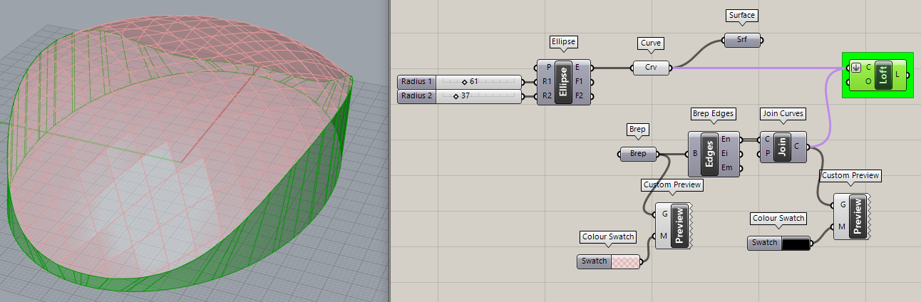

Hi, I have produced a surface starting from an ellipse and using attractor points along one of its diameters. I would like to create walls that span from the ground ellipse to the edge of the roof canopy.
I have tried a couple of options for surface creation, including loft and ruled surface, but without any success. Can anyone help?
ellipse_canopy__AB.gh (101.3 KB)
Using Loftwith “Align Section” option checked…
ellipse_canopy__AB_re.gh (102.4 KB)
Loft options ‘Align sections’
ellipse_canopy_2021Apr23a.gh (102.7 KB)
