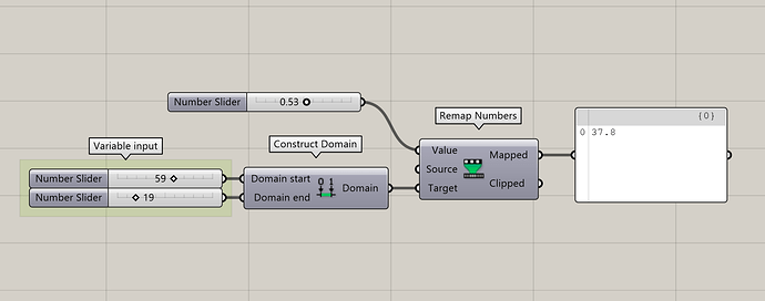

I know I’m 3 years late but just in case anyone needs this in the future, there ir a workaround to this problem.
Using remap numbers you can give it a domain which can vary on whatever other input you’ll need it to depend on and it will be mapped from a pre-set domain (in my case 0 to 1)

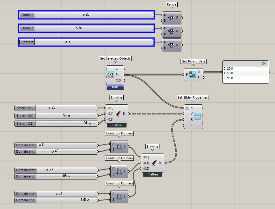

Maybe something like this?
Accepts 1D domain from number, domain, curve. Allows preserve percentage or value.
Has Step size control
DomainSlider
Add multiple grips.
DomainSliderMulti
