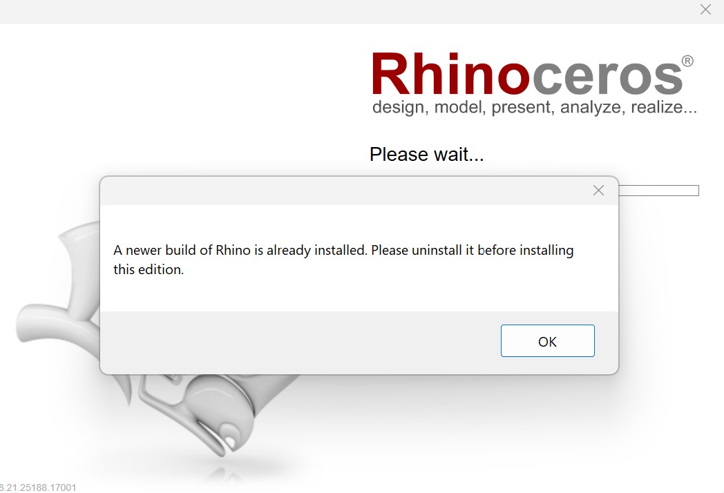

Fresh install of Rhino 8.25 is on his machine, no 3rd party rhino plugins, loaded GH plugins one by one, DKUI loaded OK with no crashes.
Then this:
Which is strange as it should be built in.
However he is now open with out a crash - I’ll send updates as I get them.

with DKUI installed Rhino crashes. It will take me some time to analyze this further.
I will first test if this crashes in an earlier version of Rhino 8.
this is interesting, in 8.21 it opens fine, but I get this unrecognized object message:
@Gijs thank you so much for helping here, I look forward to finding out more about the issue and maybe being able to fix it.
Cheers
DK
Still digging. 8.24 also opens it fine, same warning as above as expected
