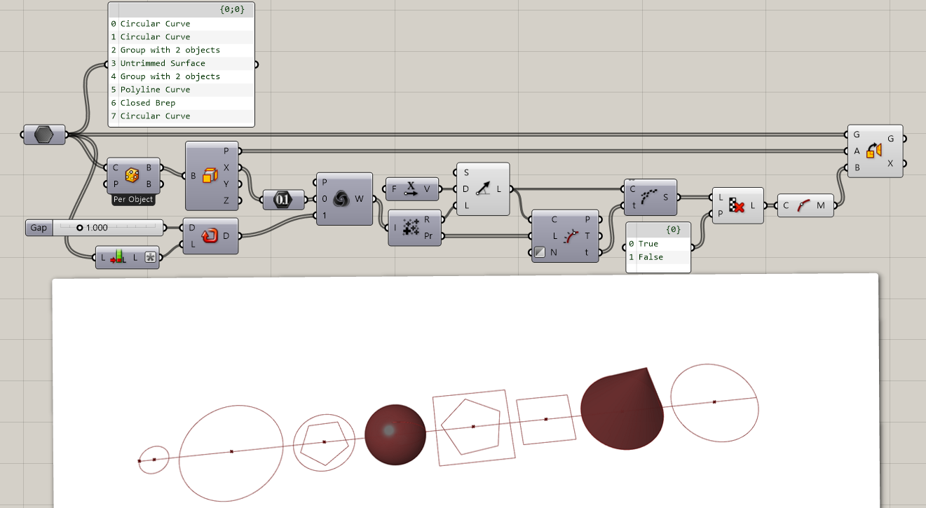

I’m trying to distribute diferent geometry ( sometimes include groups ) on a curve.
To do that in rhino I distribute randomly the geometry in between the first and the last object and execute the Distribute function and select X direction to get the result of the image attached. By the way, the selected item in yellow is a group.
I need to do that in GH but I don’t even know where to begin. Honestly I’m pretty lost in this.
I would not like to use any plug-in that has a concrete function, the thing is that I would like to make my own component that includes other things but would not like to depend on external gh components.
Any help will be very much appreciated.
Joan
