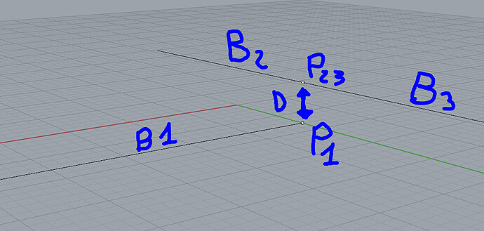

usually you want to consider a certain tolerance that can be software dependant, type of drawing dependant, Rhino tolerance itself dependant… there are cases where things that are supposed to be perfectly overlapping are sharing just “n decimals” and should be considered identical even if they aren’t, so that similarity with a percentage of threshold helps in doing that, but it’s not working correctly in this particular case because distances are very different, and a % of that distance is not a fixed number
@Ameya
there are many of these situations where B2 and B3 meet at point P23, so they certainly share one common end
but there is also the beam B1, where its end P1 comes very close to P12, the distance is a matter of a fraction of unit
do you want to setup a Threshold, like “if two points come to a distance D that is under xxxx units, then you can consider them as if they were perfectly overlapping even if they aren’t” (which means we are in a scenario where you are somehow extracting data from a drawing, and you are doing some sort of interpretation of the data)
or is your a scenario where you want to just identify curve ends that have a distance D that is not a perfect match? like a distance of 0.01 units is not a perfect match?
this makes the world of difference
