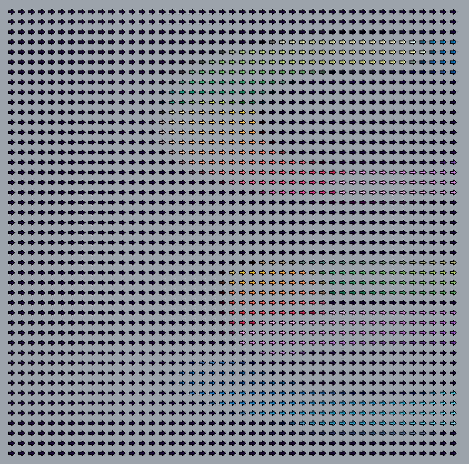

I’ve been thoroughly enjoying and, at times, finding it challenging to work with GL Shader. I’m currently stumped on how to implement a feature that toggles between world size and screen size. The example that I’ve been trying to emulate is the “symbols” shader.
I noticed that on the McNeel GitHub page, there is a shader example called “sprite,” which includes this toggling option. However, my attempts to integrate this feature into my work have been unsuccessful.

My aim is the following:
if you look at the second shader node, it has a toggle “world_size” that allows the rendered vertices to switch between real (in millimeters) dimensions, and dimensions proportional to screensize.
The same feature I would like to add the to top shader, so it can use be used with real world dimensions.
I’d thought to just take the sample code from the bottom shader as guidance, and implement it to the top shader, assuming it should be relatively easy to implementation, but not a skilled programmer, i cannot pinpoint exactly where my code breaks.
PS: both code are from mcneal github repro, with the top one with some additions i added
Attached a working example:
shader_worldsize.gh (46.2 KB)
The key was to move the calculation of the screen position from the Vertex Shader to Geometry shader:

You’d need to rewrite the rotation part to work with world coordinates and vec4 as input but I’ll leave it up to you.
thanks so much for this, iIll see if i can make the rotation and attractor work with world size. From the looks of it several modifications are necessary in both the vertex and geometry shaders.
