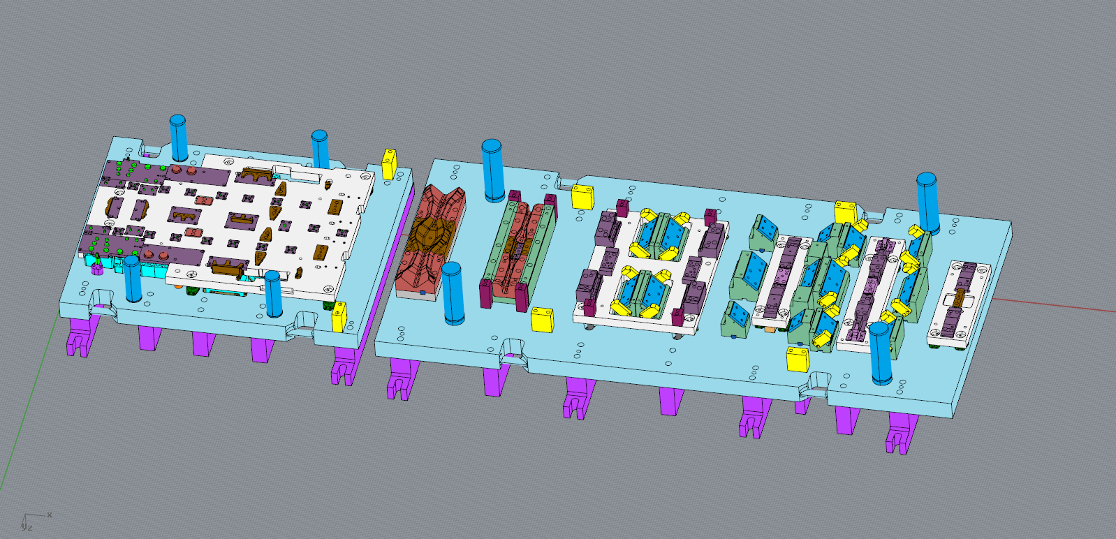

This was my first largish (approx. 50,000LB) die design in Rhino. I find it handles my larger assemblies nicely.
BOTTOM 1,800 COMPONENTS
TOP 750 COMPONENTS

I really like the color selectionsā€¦ helps to distinguish the different parts. Nice work.

Excuse my ignorance, but what is the die for?
This particular die produces a high tolerance automotive part. Roughly 600,000/year.

Thatā€™s very impressive work. I do a little mould tool modelling in Rhino but never anything as complex as this, generally just single cavity form blocks.
Do you use any plug-ins to assist? I tried a demo of Rhino Mold but as it seems to have been discontinued I decided against it. Seemed expensive for what functionality it adds - although quite useful.
I donā€™t use any add-ons. I did use solidworks to assist with a couple things (mainly filleting and some quick face removal), but that was partially because I didnā€™t know how to do some things yet in Rhino. I had been using Rhino for about 3-4 months before I tried designing this. Itā€™s been another three months since and Iā€™m sure I could do all the filleting and even cut down on the total design time by another 30%.
My customers use SW though. So when the design was complete I translated all the files into solidworks and did all my component detailing in it. Solidworks detailing is pretty hard to beat for speed. And this way everything is already translated for them
Can I ask why you donā€™t use SW to do the whole lot? This type of work is what itā€™s made for.
Iā€™m not saying donā€™t use Rhino (Iā€™ve been daft enough to use it for doing equally complex ā€˜engineeringā€™ jobs in the past) - just curious to know why you chose it over SW.
Here is a list of reasons for me. Iā€™m sure other people would disagree but this is what I have found:
  • Faster to do most things (Putting screws / holes is soo much faster with Rhino)
  • Rhino is way more stable. No more frustrating crashes and having the software hang up on things that leaves you scratching your head.
  • Direct Modeller. No more worries about history tree.
  • Better surfacing.
  • Better Community / support.
  • Less clicks to get the same thing done.
  • Price. Huge price difference
  • ā€œSketchingā€ is more intuitive in Rhino and you have more options. I find Solidworks Crashes often with sketches.
  • Cheaper hardware. Rhino runs great with GTX cards whereas Solidworks not so much. It works much better with Quadros.
  • I prefer designing on one flat level rather than having parts, bodies, assembliesā€¦ and so on.
  • Recently Solidworks made a policy change in their pricing for maintenance and upgrading costs. You now must pay retroactively for previous missed years of maintenance to upgrade. It used to be you could pay the maintenance for the year fee and upgrade to the latest version no matter how many years you had missed. If they are going to implement this policy it should be going forward, not count retroactively. Poor decision as people bought into the software thinking they could upgrade at any time for the low price of the one year maintenance.
  • Solidworks does not allow to save in previous versions. This way you are strong armed into keeping up with the latest versions. Sleezy practice.
ā€¦ The list goes on.
Iā€™ve used SW for 9 years (what I first learned 3D design with) and since trying Rhino last June I havenā€™t looked back. I still like it for some things, namely detail drawings.

Thanks but unfortunately I wonā€™t get to see either. Iā€™m a contract designer and the shop is about 400km away. I rarely get to see my designs or even my customers in person.
I just realized that I lied. I do use a Plug-in. I use Pascalā€™s Extract Tangent Faces. That is very helpful with this kind of work.
